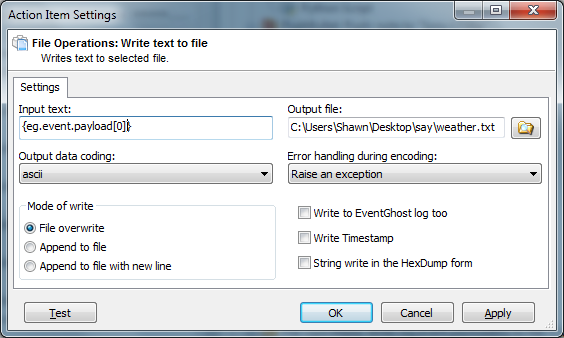

filepath will be:
C:\Users\Shawn\Desktop\say\weather.txt
and it will be overwritten everytime it is launched.
Re: PushBullet plugin (Pako)
You must add plugin "File Operations" into your configuration.
<EventGhost Version="1669">
    <Macro Name="File Operations: Write {eg.event.payload[0]} to file: C:\Users\Shawn\Desktop\say\weather.txt" Expanded="True">
        <Event Name="PushBullet.Note.Weather" />
            FileOperations.Write(3, u'{eg.event.payload[0]}', u'C:\\Users\\Shawn\\Desktop\\say\\weather.txt', 0, 0, False, False, False, u'ascii')

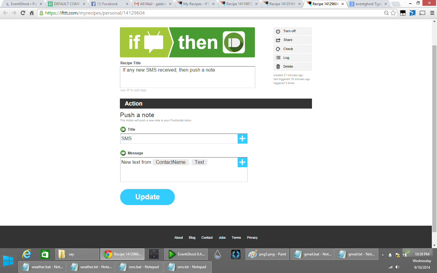

I know your English isn't 100%, so I've included multiple pictures to help you see what I'm doing.

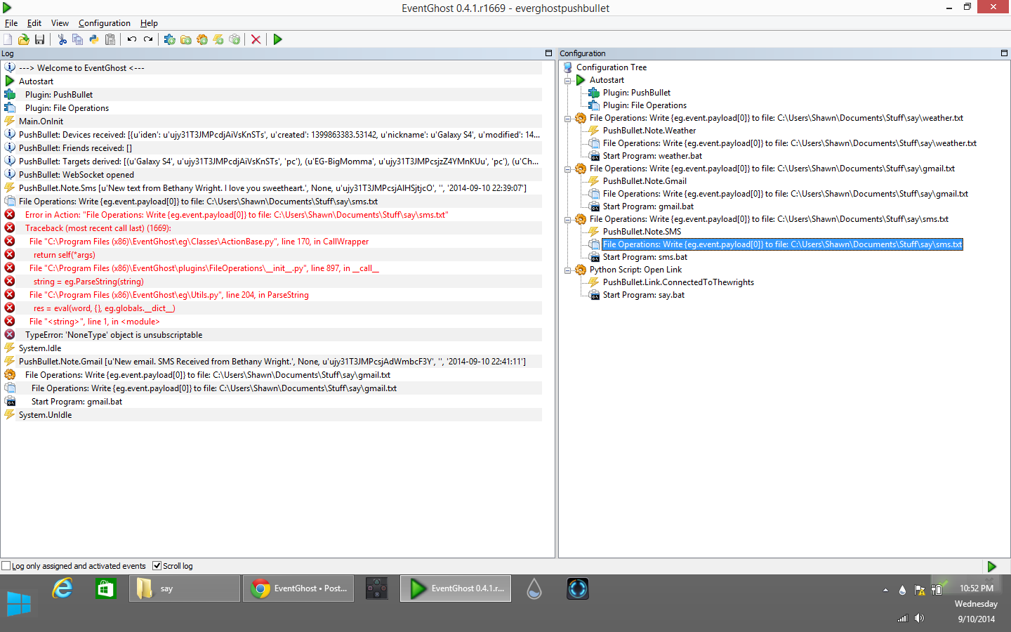

Ok, that worked, when I did it by itself. I added several other macros though to do other tasks, and I keep getting this error.

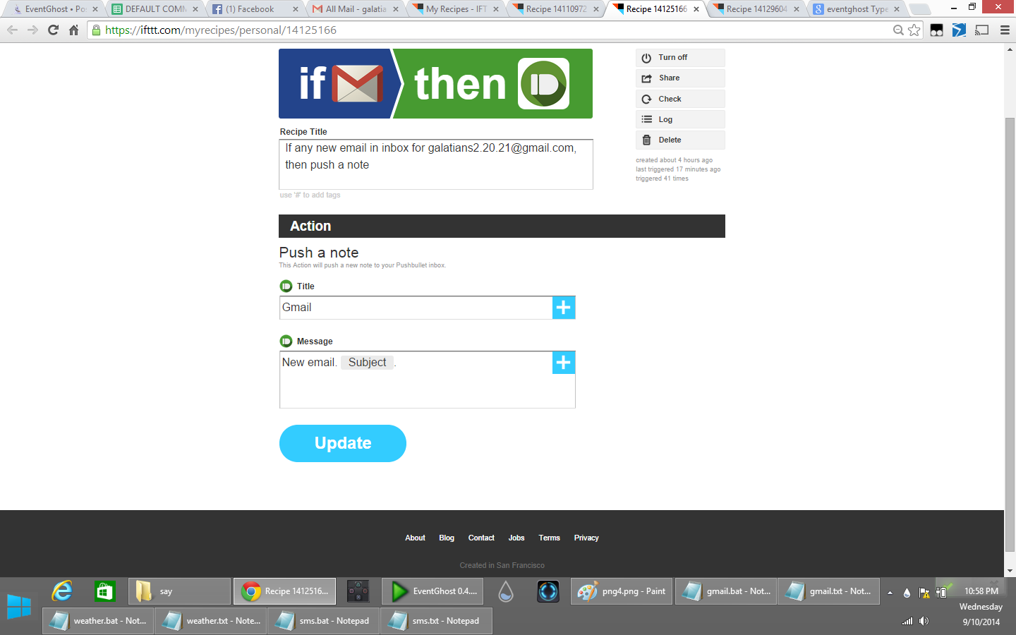

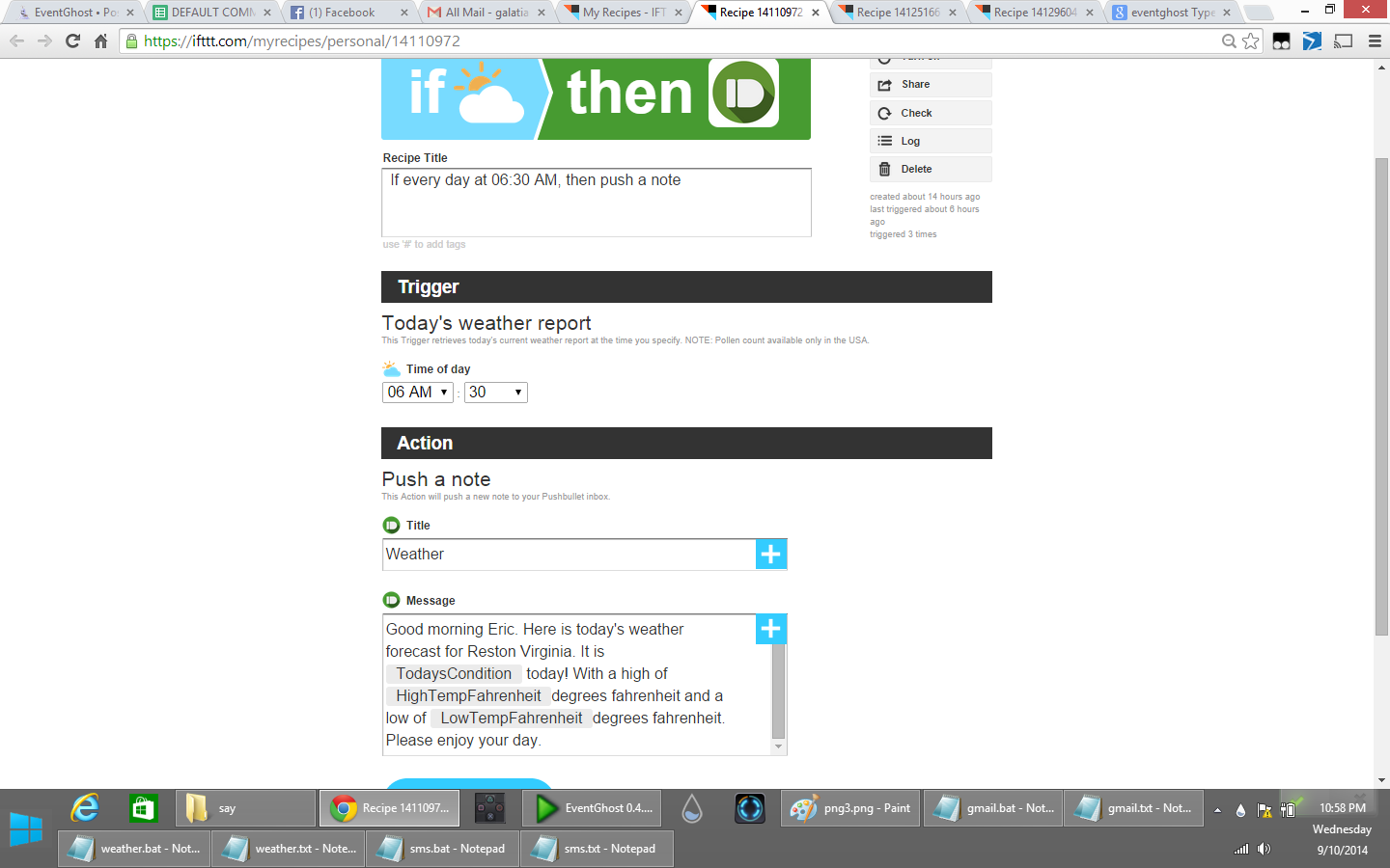

First of all, I use the IFTTT website to automate all of my PushBullet actions (http://www.ifttt.com). I've given you a glimpse at each of my three IFTTT recipes so you can see from start to finish how they work. I will note, this worked fine with no problems until I added more than one macro.
Do you know how to fix this error?

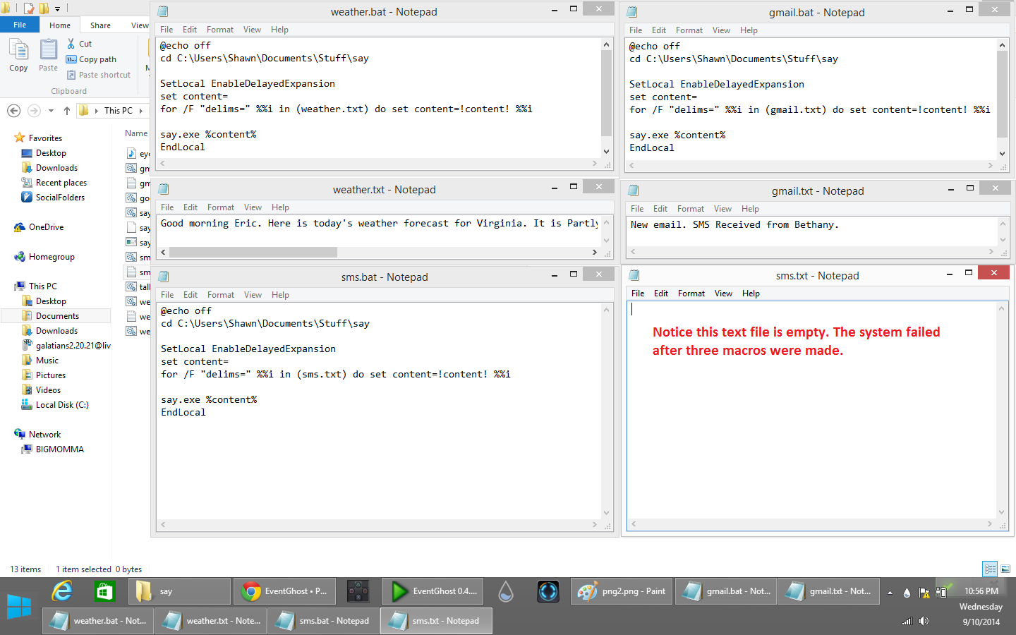

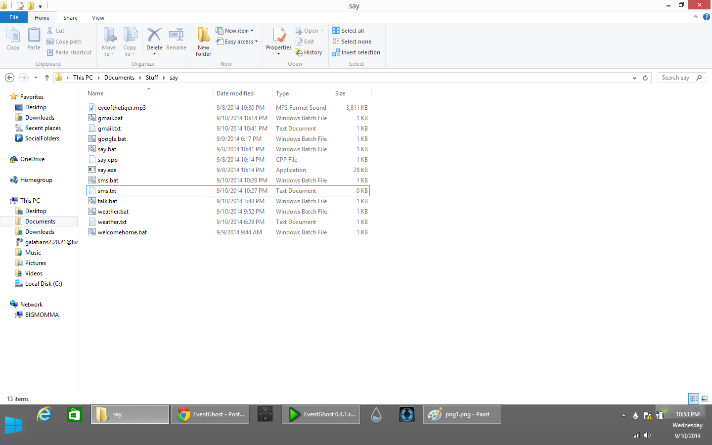

This is the actual code I'm using for my batch files.
These are all my batch files I'm running and their associated text files
You can see all the configurations on the right, and the error on the left.

I've attached the remaining screenshots for your review.
3rd IFTTT Recipe
3rd IFTTT Recipe
2nd IFTTT Recipe
2nd IFTTT Recipe
First IFTTT Recipe
First IFTTT Recipe
You're trying to confuse me.
You're obviously starts up manually the action "File Operations: Write {eg.event.payload[0]} to file: C:\User\Shawn\Documents\Stuff\say\sms.txt".
It can not work, there is no payload.
1) Please turn on the "Log Times" (in the "View" menu). This gives a much better overview of what is happening.
2) Python is the "Case sensitive". So if the event looks like "PushBullet.Note.Sms", you can not expect to run the macro, where the event looks like "PushBullet.Note.SMS". Note: Event prefix is automatically adjusted so that the (potential) spaces are omitted and the first (and only the first) letter of each word is uppercase (other letters are always lowercase).

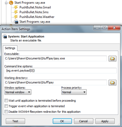

3) Solution using bat file and txt file is useless. You can use the action System: Start Application directly to start the program say.exe.
It should look something like this:
shawneric
Posts: 16
Joined: Sun Sep 07, 2014 6:59 am
Post by shawneric »
ah, see, it was I who was confused, not you :P. That works PERFECTLY!!!! :) Now there's a LOT I can do :D Personal Assistant here I come! :D

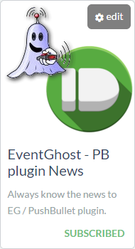

PushBullet developers launched a new cool feature - channels.
Learn more from the article Introducing Pushbullet Channels.
That's a bit like MQTT, but you can also send files and you need no own server for it.
So I also worked a bit, and the new version (0.1.2) PushBullet plugin already supports channels !
Another new feature in this version is action Push reply.
And I even (more or less to test) also created a channel.
Using the link below you can subscribe to it !
Subscribe to channel EventGhost - PushBullet plugin News
