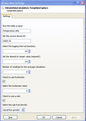

- You can configure how frequently you want to save readings (default every 10 minutes)
REVISED:
- For rain, the plugin calculates two moving averages, one fast and one slow. This is then used to create events when the lines are crossing each other. The more readings you select, the slower the response to changes. This is a very useful function to when you are looking for trend shifts (in this case, if rain is increasing or decreasing during time).
- In addition you can add a hysteresis value that will set the upper and lower band (+/- hysteresis/2) for the fast moving average before it triggers an event
- For temperature and humidity, the plugin calculates one moving average. This is then used in combination with the set-point and optionally the hysteresis to create events when the lines are crossing each other. The more readings you select, the slower the response to changes. This is a very useful function to avoid too many status changes when for instance controlling heaters with on/off control equipment (you might temporary open a door or window but the heater should not react immediately)
- In addition you can add a hysteresis value that will set the upper and lower band (set-point +/- hysteresis/2) for the moving average before it triggers an event
- You can select if you want to use the rule evaluation that will generate those events or not. Currently I have only one rule 'equal-less-greater' that will generate events when moving average gets equal, less or greater than its reference.
- All this works for rain level, temperature and humidity data

1) Start to collect sensor data
You just add a 'DataCapture' macro, name the database table and put in the sensor id. Configure the rest of the parameters if you do not accept the default. If you check the box '..use a rule' you will receive events when conditions are met as described above.
Then drag & drop the event from the sensor to the macro. You are done, data will be collected as soon as new sensor events arrives.

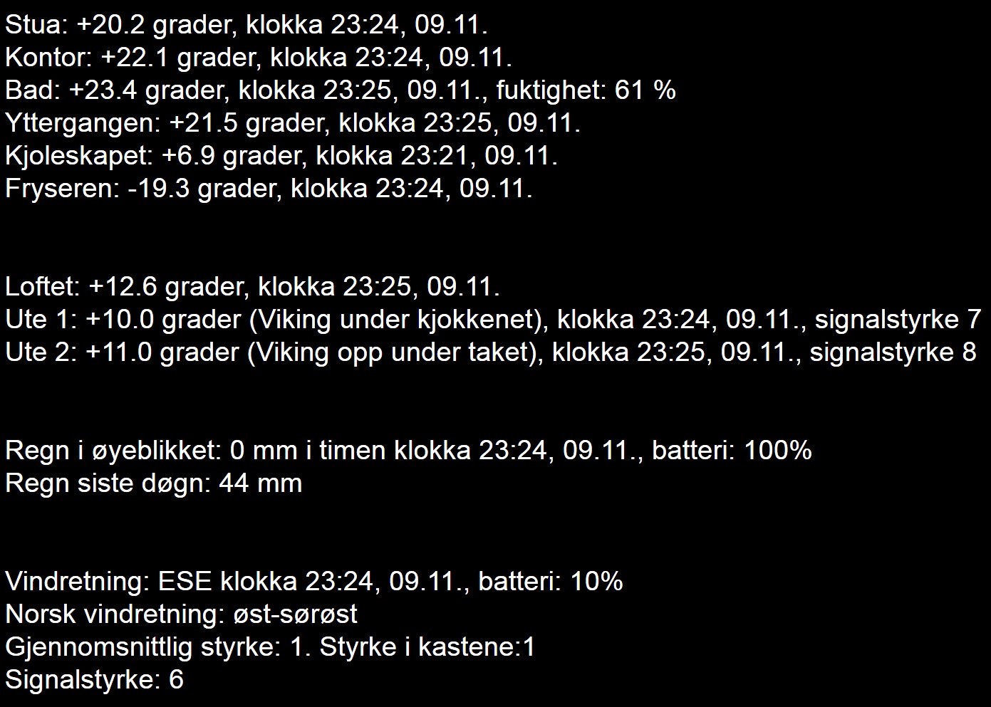

I can do you one better. :lol: Here's first the rain sensor:
23:06:23   RFXtrx.Type: PCR800 id: 25856 ' rainrate: 0 mm/hr rainTotal: 34 mm signal: 7 battery: 100%'
And then the wind sensor:
23:07:37   RFXtrx.Type: WGR800 id: 28928 ' direction: SSE average speed: 2 m/s gust: 1 m/s signal: 6 battery: 10%'
The 10 % battery is constant, I'm using a solar panel with built in rechargable battery, and no matter how much it's charged the sensor only shows 10 %.

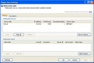

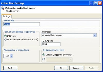

1) Since you are running the WebsocketSuite plugin, I assume you have the Webserver plugin added as well? First thing is to drop the demo.html file in the web server root folder. Try to open it like http://your_ip:port_if_not_80/demo.html
2) Check that you have similar settings like below and that the websocket server is running on port 1235 (and listed as such)
Mastiff

Got it, thanks! :) I was almost correct, I was only missing the "start server" action. Now I see the stuff coming in. :D So I assume I'm ready to use it for something, but I'm not quite sure what. I guess that will surface with your plugin. :) As for my regular webpage with temperatures and stuff I have actions like this one:

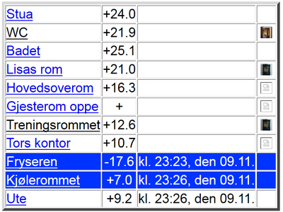

import time
eg.event.payload_copy = eg.event.payload
my_data = eg.event.payload_copy.split(' ')
td = my_data[2] #temperature
timeStamp = str(
time.strftime("%Y-%m-%d %H:%M:%S", time.localtime())
eg.globals.Stua_time = timeStamp
eg.globals.Stua_temp = td
eg.globals.Stua_time_formatert = "%s:%s, %s.%s." % (eg.globals.Stua_time[11:13], eg.globals.Stua_time[14:16], eg.globals.Stua_time[8:10], eg.globals.Stua_time[5:7])
And then I have the simple webpage at the cabin:
And a bit more complex one at home, which shows if there's a heater on with an icon - the one missing the icons haven't had the heater scripts activated since the last reboot of the server:
