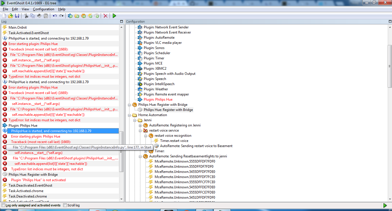

Re: Philips Hue plugin
Thanks for doing this. I was just about to start writing REST commands. This saves me a good amount of time. A couple of questions. Is 2.0 broken for anyone else? I tried reinstalling various versions of EG to no avail. It seems like it's kicking back on the username. Reverting back to 1.0, on build 1669 has things working well again. Also, in 1.0 i'm not getting any return values when issueing get status macros. Is there something i'm missing? I'd like to see grouping added to the plugin too. Again, nice work.
You have to use the "Register with Bridge" function before you try to use any functions, this is required even if you registered with 0.1.0. You have to set username in the config before you run the "Register with bridge" function. The phue library I used earlier implemented username and user-type wrong. Please leave any logs of errors here if this does not work.yokel22 wrote:Thanks for doing this. I was just about to start writing REST commands. This saves me a good amount of time. A couple of questions. Is 2.0 broken for anyone else? I tried reinstalling various versions of EG to no avail. It seems like it's kicking back on the username. Reverting back to 1.0, on build 1669 has things working well again. Also, in 1.0 i'm not getting any return values when issueing get status macros. Is there something i'm missing? I'd like to see grouping added to the plugin too. Again, nice work.
It may be that the "getstatus" function was broken in 0.1.0. In 0.2.0 it returns a dictionary of the light.
The next major upgrade I plan is for group commands. It seems quite straight forward to implement.
Sorry if i was unclear. In 1.0 the getstatus commands were firing fine but just didn't return a value. In 2.0 i tried once again installing as instructed. When i add the plugin i get this message(PhilipsHue is started, and connecting to: 192.168.1.79). Followed by a slew of errors pictured in the attached screenshot. When i try to register the bridge it gives this error(Plugin "Philips Hue" is not activated). Yes, i did remember to push the button.
Ahh, I see what is happening. I implemented the events after I had run the "Register with the bridge" on my own computer, so I never discovered this bug. The eventthread is trying to connect to the bridge before it is registered, and this breaks the plugin. If you comment out everything after "self.username = username" in the __start__ function of the PhilipsHue, does the plugin work then? If this works you can register with the bridge, exit EG, uncomment the lines and restart. Then it should work. I don't have a 2nd computer available right now to check this. I will make a bugfix as quick as possible.yokel22 wrote:Sorry if i was unclear. In 1.0 the getstatus commands were firing fine but just didn't return a value. In 2.0 i tried once again installing as instructed. When i add the plugin i get this message(PhilipsHue is started, and connecting to: 192.168.1.79). Followed by a slew of errors pictured in the attached screenshot. When i try to register the bridge it gives this error(Plugin "Philips Hue" is not activated). Yes, i did remember to push the button.
I have published a new version 0.2.1 (see first post), this should fix the problem. After changing username and registering with the bridge, you should restart EG to get events. Does this work?
(As you see I have started implementing group commands, but its not finished in this version. And the layout of the "createGroup" config is terrible.)
Yep, working well now. I'm still not getting any returns on the getstatus commands. Everything else is working well. I like the subdivisions you threw in too. Is it possible to send toggle commands to the api?
