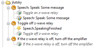

I made a picture that would illustrate the situation.I understand this correctly?
Here offer other important issues, otherwise I can not continue.
How will I know, that the z-wave relay is off ?
The time between the command to toggle off the z-wave relay and its real switch-off is highly variable?

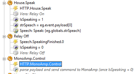

Here is a screen grab of my specific setup.Pako wrote:I made a picture that would illustrate the situation.I understand this correctly?
On my Vera, I send off 2 HTTP requests to EventGhost, one right after the other.
http://192.168.x.x:8082/?House.Speak&TextToSpeakOutLoud
http://192.168.x.x:8082/?MonoAmp.Control&0&Power&0
Even though both HTTP events are being triggered from my Vera at the same time, the 2nd event 'MonoAmp.Control' needs to wait to execute it's python script until the first event 'House.Speak' finishes speaking, and subsequently triggers the 'Relay Off' macro.

I do not understand the configuration.
1) Why do you need that event HTTP.MnoAmp.Control, when both events (along with HTTP.House.Speak) you are sending at the same time?
2) Why the event Speek.SpeakingFinished.0 is not used directly in the macro MonoAmp.Control?
3) What is the point of the variable IsSpeaking ? It is used anywhere else?
Re: Macro Wait until event or condition
1-2) In other scenarios I sent just HTTP.House.Speak without any MonoAmp control. And in other scenarios I send just HTTP.MnoAmp.Control without speaking anything. They have independent uses, in addition to being used together sometimes.Pako wrote:I do not understand the configuration.
3) IsSpeaking was a hold over variable from something else. I can get rid of that now.
