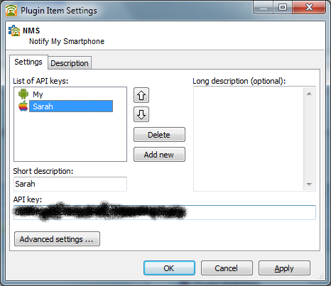

This new plugin combines clients of services NMA and Prowl.
This means that you can simultaneously notify an iPhone as well as an Android device.
Of course this is not a requirement. You can use this plugin, even if you have all the devices of the same type (iPhone or Android).Very significant help in the development and testing plugin provided me krambriw. Thank you very much!
