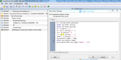

I'm trying to get a variable from a payload to run in the nest plugin. I have everything parsed out fine but it tells me it's an invalid format. The script works fine when i substitute my variable with a integer. I was hoping someone here might be able to tell me what i'm doing wrong.
p = str(eg.event.payload)
print eg.event.string
print eg.event.payload
p = p.split(',')
d = p[1].lstrip("[' ")
id = d.rstrip("'")
t = p[2].lstrip(" ' ")
temp = t.rstrip("'] ")
eg.globals.temp2 = temp
print eg.globals.temp2
eg.plugins.Nest.set_temp('temp2', 'id')

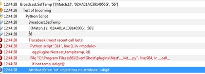

Pako,
Thanks for your help. This is what it's kicking back on your script.

I actually am the creator of the Nest plugin, while I don't update it anymore do to their newer terms of service, I can help solve this really easily.
You did everything correct up to your last line. By placing the 'temp' and 'id' it was not getting the value in the variable. Like in what Pako had.
eg.plugins.Nest.set_temp(temp, id)
works just fine with the incoming string you had.

Thank you both. I feel silly having to ask these kinds of questions. Sure enough, it's working beautifully now. I could of swore i was passing the user id through.
