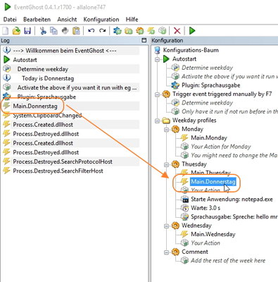

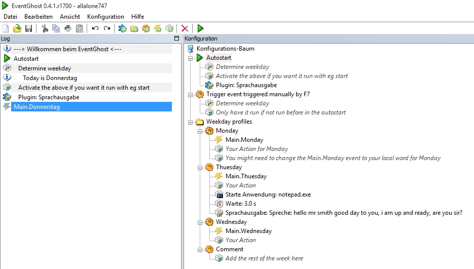

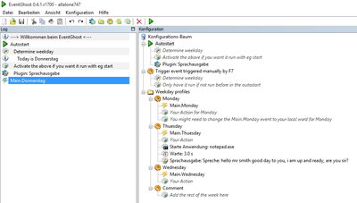

- Posts: 81
- Joined: Sun May 03, 2015 2:17 pm
Re: Event Ghost event launcher
Hello Luca
Good day to you, i am back again, asking for your guidance with Event ghost
you send me a file that you name Allalone747.xml, great but now i am trying to add my action lines for each day , what i am having is
Activate the above if you want it run with eg start
Even tghost start but no action
Cheers
Cheers
- allalone747.xml
- (2.81 KiB) Downloaded 140 times

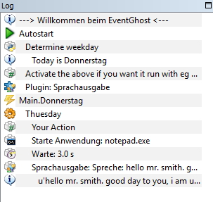

- Luca Brasi
- Posts: 262
- Joined: Sat Oct 11, 2008 12:39 pm
I guess thats because of your local setting.
I am here in Germany and set the xml up in english.
So when I run it I get So I will have to pick the line "Main.Donnerstag" and drag it to the fitting action: After saving and restarting I will get this:
