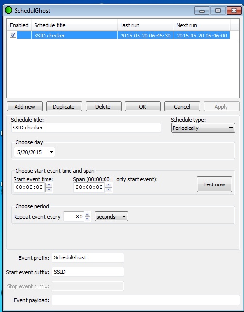

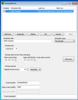

So for setting this up you can use scheludeghost plugin. This is probably the easiest way for someone new.
Load the plugin, setup were to save the scheduleghost setting file, then click on "Show scheduleghost manager"
"Add new" Make one that looks something like this:
You can change how often you would want it to check.
Apply thru both screens (getting you back to eventghost main screen.

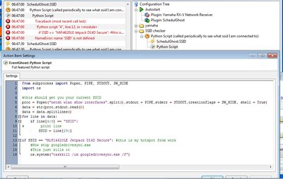

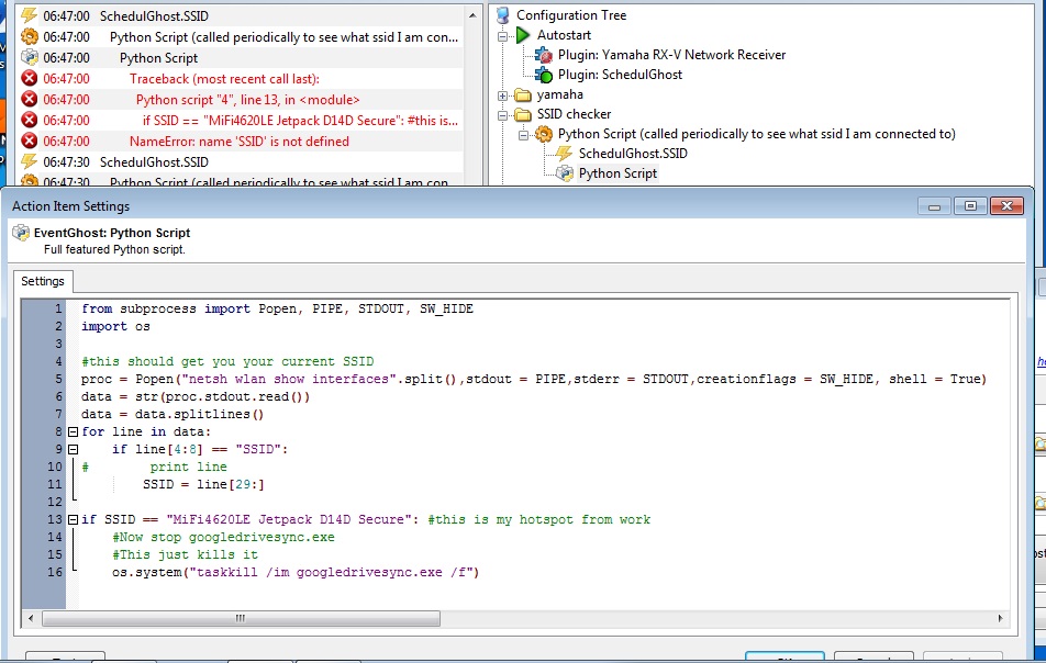

If you did my settings in a little bit a new event will show up the the log.
Click and drag it to the spot of your script. The whole thing should look like this:
I use a much longer and very specific script (bluetooth discovery) for starting/stopping/preventing automated backups.
If you are getting an error in the log about SSID variable is not defined then remove the # from the "print line" Some thing might be wrong in the formatting of the output. You will just have to adjust the line and position of what it grabs.
