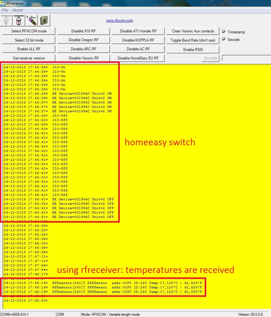

Hi Walter,
In the RFXtrx-plugin I told you about an older RFXReceiver I bought and wanted to get to work (viewtopic.php?f=9&t=3801&start=255#p27399)
Since editing the RFXtrx-plugin was not a feasible solution, I tried the xPLtrx-plugin as you suggested (viewtopic.php?f=9&t=3801&start=255#p27399)
This plugin almost works perfect in combinaton with the xPL-components, but there's one thing I hope you could help me with.
My main goal is to monitor temperatures and create logs. The test setup includes a RFXSensor (1-wire) and a Home Easy switch.
When using the switch, the command is received and displayed in EventGhost. But when receiving a temperature nothing is showed in EventGhost.
- When I use the test program 'RFreceiver' the temperature is displayed: The sensor and receiver work.
- I have enabled the raw data mode, but nothing is displayed in Eventghost when receiving a temperature signal.
- I've tried all the versions of your plugin, now using the latest.
Is this something in the plugin? Or should I look in the xPL-configuration?

Thank you for your fast reply,
- Yes, I'm using your RFXcom_xPL plugin in combination with an 'old' version of the RFXReceiver (http://www.planete-domotique.com/media/ ... xcom_r.jpg). This 'old' version does not work with your newest RFX plugin.
- Yes, I installed xPLHub, xPLHal, xPLRFX and xPLDiag.

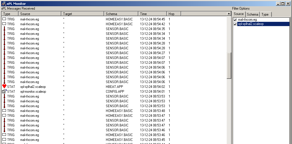

If you have xPLHal installed, you can start the xPL Monitor in xPLHal Manager and verify that your events are appearing correctly on the xPL network

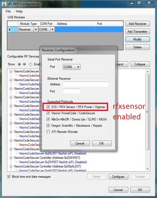

Hi Walter,
I did some testing with the following results (see screenshots):
- In DCM I cannot see any temperature signal from the RFXSensor (Screenshot 1)
- The xPL RFX Configuration looks correct (Screenshot 2)
- Using the RFreceiver utility, I can see temperature signals from the RFXSensor (Screenshot 3)
My guess is that something's wrong with the xPL RFX Configuration, since DCM is also not showing the temperatures.
Do you have a clue where I can check this?

Problem solved!
Walter: Thank you for your help.
After searching xPL-forums I found the reason for this behaviour:
When having your xPL-setup configured and running, you need to reset the RFXSensor by pressing the internal button.
That causes an initialization message to be sent, which is needed by the xPL-setup.
If this message is not received, the device will be ignored. RFreceiver does not need this message, but xPL does.
After the reset the temperature was shown in DCM, and also visible in EventGhost by using your plugin.

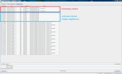

Maybe I should add that I get information messages from various sources in the log, for instance from another laptop.
However, I want to get the events from the RFXCom Lan Transceiver (I believe you also have this device).
I do get information messages from it, including for the ones I need (e.g. information messages saying 'X10 device such and such motion - on"), but just no events in the log, whatsoever.
This means that the actions for which I have trigger events from the Transceiver set up don't work.
Also worth noting is that the information messages I get in the Eventghost log list the port number in them for all sources, except for the RFXCom Transceiver: here, the information messages do not include a port number, just the information from the X10 devices that is passed through.
Hope this explanation helps a bit more.

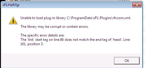

I gets an error when I start xPLhalManager
Unable to load the plug-in library c:\xx.xx.xx\rfxcom.xlm
the library may be corrupt or contains errors...
the spesific error details are:
the "link" start tag on line 86 does not match the end tag of 'head'. Line 161, position 3.
I tryed todelete the plugin and install again ... with no luck...
any tips?
