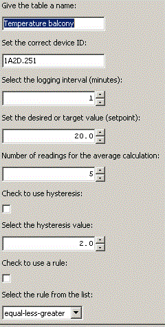

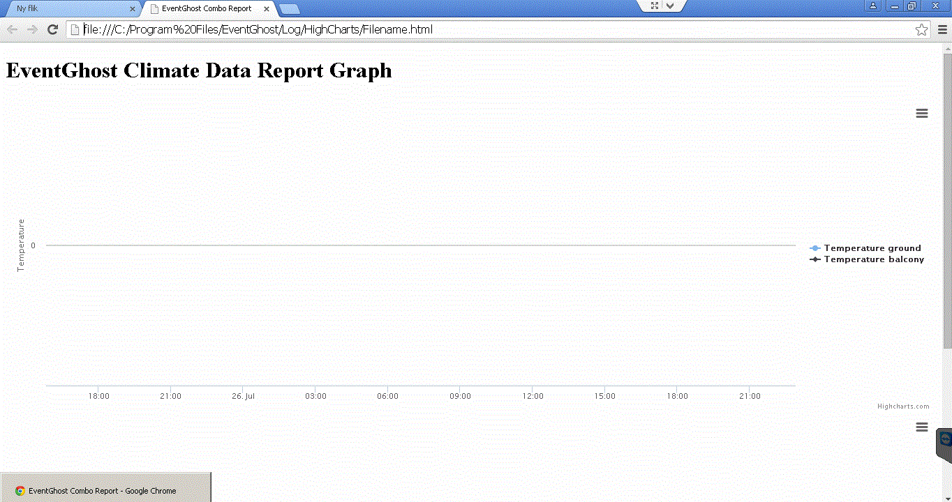

First mistake, I did NOT have highcharts zip package.
I downloaded it and now it displays info, however, it is zero.
Settings are:
If climateplugin does not utilize websockets then we do not have to troubleshoot it as I do not use it in EG :)
/Nicklas
Re: ClimateDataCalculation
You are almost there.
Instead of 1A2D.251 as device ID, use only 251 and it should work. To get a clean db, you could first delete the temData.db file to start from scratch

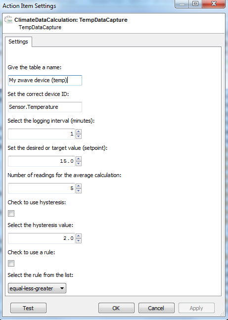

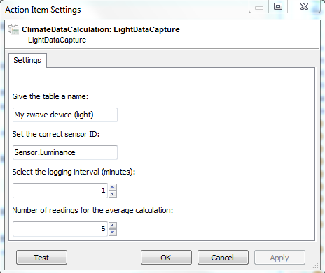

I have tried to make a new version hopefully supporting your z-wave device...
Requirements:
1) Download the new version (the __init__.py file) from link below and replace the existing one
2) Restart EG
3) Create 2 new macros with actions to capture temperature and light respectively
4) Settings should be similar to below for your sensor
5) Drag & drop the z-wave events to correct macros and the logging should start
6) After a few events you should be able to create a combo report and select the new sources
For debugging reason, this version is printing the captured value
Lets see if it works ;)
