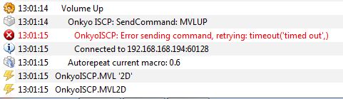

Thanks for taking this on! I've tried it and it works well, thanks.

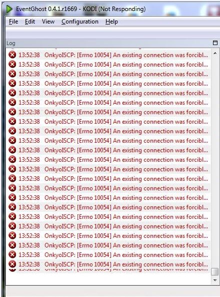

One thing that would good to fix if possible is, that if the NIC is disconnected it locks up EG, (2nd image), and on restarting it won't connect, (1st image). This means if the PC, or EG locks up then it has trouble re-connecting. You can simulate the crash just by disabling/re-enabling the NIC under adapter settings.
Thanks again!
Thanks again!
Re: OnkyoISCP plugin
Well, took a while to get a working testcase up and running but I believe it's fixed with the latest release. Can you see if the issue is solved for you?
Great work, it doesn't get stuck in a loop any more and kill EventGhost.WoLpH wrote:Well, took a while to get a working testcase up and running but I believe it's fixed with the latest release. Can you see if the issue is solved for you?

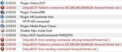

Exactly the same as the 1st image in my post above:WoLpH wrote:What is the result when it can't reconnect? Perhaps I can automatically have it retry when you get anything like that.
error sending, retrying
failed to connect
error sending, timeout
download/file.php?id=4551&mode=view
Edit: I left it for quite a while and only disabled/enabled my HDMI output of HTPC and got this:
