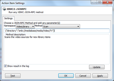

thanks for a great plugin, I've been using it a lot. I have a question tho' is it possible to send a command to kodi that makes kodi just update part of my library? I don't want to update moveis, only TV-shows because my moviescraper is really bad. I've tried searching around, but can't seem to find anything, maybe my search words are bad but does anyone have any idea how I can only update TV-shows?
Thanks in advance!
bengalih
Posts: 48
Joined: Sat Feb 25, 2012 1:13 am
Post by bengalih »
eirik226 wrote:Hello,
Thanks in advance!

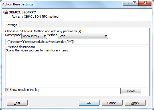

XBMC2 > Experimental > JSONRPC
example
example
The text in there is:
{"directory":"smb://mediabase/media/Video/TV"}
Replace with your path as defined in kodi/userdata/sources.xml

Thank you so much - if your reply was the it's more XMBC question then EG (before edit), the reason I asked was exectly what you showed me - how I could do it in EG, anyway thanks for your reply, helped me out a lot!
The reason I must do this in EG:
I run kodi and all other stuff on a Intel NUC (small computer) that is on 24/7 - but I use it for a lot more then just Kodi, so I use directory watcher to see if any new files have been created, if so, EG starts kodi, sends update command, wait some time and then exit the application. (So it's like the update never happend)
One more question - is it possible to automate the shutdown process after the library update? Right now I have "Wait some time 240 sec" (It will take around that time to update the library) then shutdown, but i'm afraid it might take longer sometimes and EG force a shutdown in the middle of the update - anyway around this?
