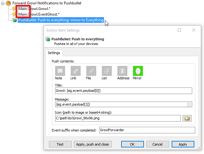

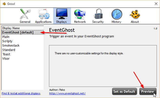

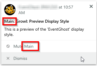

Pako wrote:
cparker15 wrote:So, when I see my Growl notifications mirrored via Pushbullet, they show up as coming from the "Main" app, meaning the title of the push is prepended with the string "Main: " and I get an option to "Mute Main" on the mirror notification.
Could this please be changed so that a custom application_name can be specified via the PushBullet Mirror action?
Unfortunately, I did not understand your problem (my English is weak).
Can you explain it in other words?
Probably would help an image attached to it.
I'm going to provide a series of annotated screenshots to illustrate the issue I'm talking about. Please let me know if this clarifies my meaning.
(more than three screenshots, which is post maximum; remaining screenshots in next post)

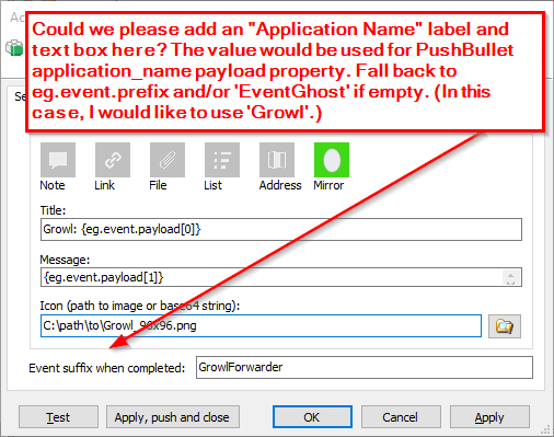

(continued from previous)
03 EventGhost PushBullet application_name eg_event_prefix.png (6.19 KiB) Viewed 5322 times
04 Pushbullet Popup Growl EventGhost Display Preview.png (12.58 KiB) Viewed 5322 times
I hope this clarifies things. It would be helpful if the application_name could be customized, other than using either the event prefix or 'EventGhost'.
Pako wrote:
cparker15 wrote:However, in the Pushbullet Windows application and the Pushbullet Chrome extension, I see empty space where the icon should be, next to the push title.
I tried it now and it's true. Previously it worked, something probably been changed.
I'll try to make some adjustments to make it work again.
This works great now! Thanks so much for the quick turnaround on this bugfix! :D
Re: PushBullet plugin (Pako)
cparker15 wrote:I hope this clarifies things. It would be helpful if the application_name could be customized, other than using either the event prefix or 'EventGhost'.
I created a new version of the "Display for Growl".
It can be downloaded here (version 1.1).
Unlike the original version, there is no longer a prefix "Main".
I understand that this does not solve your problem.
I could, of course, add a textbox to define the application name.
But I still do not understand what's the point.
Are you aware that the "mute feature" is not available in this case (it only works for Android applications)?
This is intended only to supplement the information?
