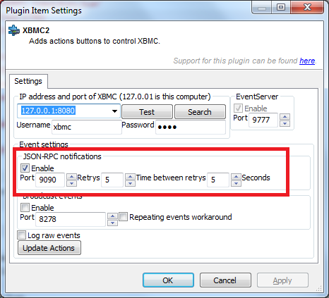

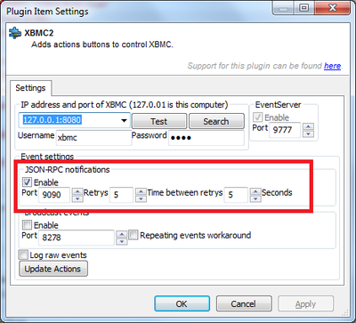

You can enable JSON-RPC notifications in the XBMC2 plugin as shown here:
enable json notifications

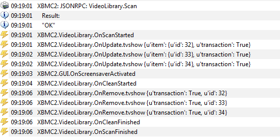

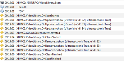

Then, you will start to receive JSON events FROM XBMC into event ghost...you will see the following:
json clean events
json clean events
You can use that .OnScanFinished event to trigger a shutdown.
