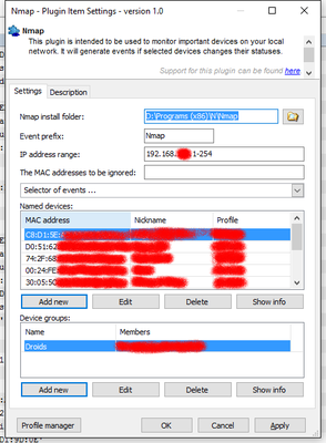

Re: Nmap
Okay further to our earlier conversation Pako I now have the boxes populated and that end of the plugin seems to work just fine but I am not getting any results displayed and returned to me
I am using the following short python prog to display results immediately after executing a Npap:Get MAC Address request on a permanently connected device (10.1.1.2)
print "Result = " + eg.result
print "String = " + eg.event.string
print "Prefix = " + eg.event.prefix
When I use the commands I get this result in the log:
18:55:38 Nmap: Get MAC address: 10.1.1.2
18:55:38 Python Script
18:55:38 Device is Present
18:55:38 Result = IP address "10.1.1.2" not present
Similarly if I execute any other Nmap command I get the same results
Can someone explain how this works.

Re: Nmap
There may be several reasons, and it is difficult to find the cause from afar.
I have a few questions:
1) What is the IP address of a PC running EventGhost?
2) The command ping 10.1.1.2 is successful?
3) If you run nmap (Zenmap) directly, then the device with the address 10.1.1.2 is there to see?

Re: Nmap
Pako I rebooted my system and then reinstalled NMap
It now works ....
I suspect it is because Windows needs a reboot for the system PATH variable to be actioned after installation adds the NMap location details.
As others seem to have experienced this issue I suggest you may like to add a note to your first post that a system reboot is required and possibly reinstalling could solve any additional problems.
I am excited about the opportunities your plugin provides me for my home automation projects.
Again many thanks.
- Wayne
