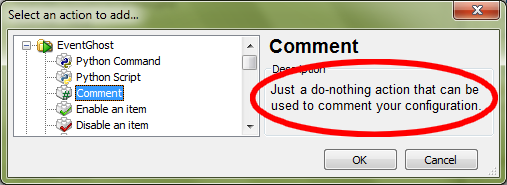

I think that the Bitmonster (author EventGhost) thought of this problem.
You have two ways to do it:
1) Edit the macro name
2) Add action Comment, and then edit the name of this action.Pako

Ah perfect, thank you very much.

Old thread but a solution to a related issue: Sometimes when I'm debugging I'd like to make some notes into the log(s) to document my progress. I just execute the comment. Voila!
