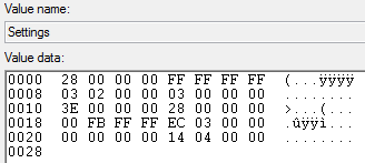

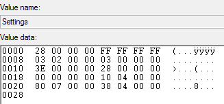

Value of the key when the taskbar is on my main monitor (HP 23xi IPS LED Backlit Monitor 1920 x 1080):
Value of the key when the taskbar is on my second monitor (DELL E173FP 1280 x 1024 ):
If it can help you, this link explains what is StuckRects2. I honestly don't understand why the values change after reading this website: http://www.dabcc.com/article.aspx?id=9724
I think I could just put the value of the second monitor when I unplug the TV, but I'm really not comfortable with registry editing and I don't understand all the value types. This is the reason I am asking on the forum, to see if there is a better way to do what I'm looking for. If you need more info to help me don't hesitate to tell me!
