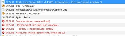

I have some challenges - Have I done it right?
Error when running the script
The macro I have created with the script
Re: Activate macro when battery status in payload reaches 1?
looks right
i need to see the whole event that is causing the error

Looks like this:
07:20:17 RFXtrx.Type: Viking 02811 id: 43008 ' temperature: +20.6 deg C signal: 7 battery: 9'

Okay - I am to blame - the Battery alert works perfectly on my PIR sensor (look below) - but on the temperature sensor it does not (see below).
Any ideas - it seems that it has the same "battery" name in the event.
Battery alert on temperaturesensor not working properly
Battery alert on PIR sensor working perfectly

ok add this line at the top.
eg.event.payload += ' '
# edit the 2 variables below to adjust the trigger points for the events
WARNING = 9
NOTICE = 15
data = eg.event.payload.split(':')
deviceData =  dict([[data[i][data[i].rfind(" "):].strip(), data[i+1][:data[i+1].rfind(" ")].strip()] for i in range(len(data)-1)])
if 'battery' in deviceData:
    battery = int(deviceData['battery'])
    prefix = 'SensorBatteryWarning' if battery <= WARNING else 'SensorBatteryNotice' \
                if battery <= NOTICE and battery > WARNING else False
    if prefix: eg.TriggerEvent(
                            prefix=prefix,
                            suffix=eg.event.suffix,
                            payload="current battery level is at "+deviceData['battery']+"%"
copy and paste it there is a space between the single quotes.
i wasn't paying attention because my script uses the space between the items in the payload as a marker for when the value for an item has ended.
and guess what??
there is no space at the end of the last item.
so what that does is just adds the space to the end of the payload data
funny thing is i had it keyed in on my test over here i must have copied and pasted it missing that line.
