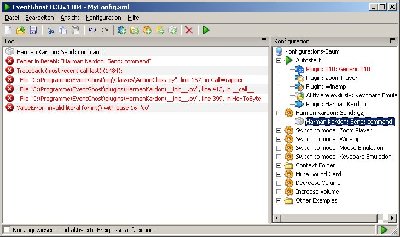

There are just now a new problem. When I click "run" for "test" command, a lot of error messages tell me eventghost. Look new screenshot.
How we can fix this error?

There are another problem, you said not anything to them. You have don't understand my bad english...? Sorry.
Problem is: Event Ghost dont send any command. Event Ghost tell me a lot of error messages. I switch EventGhost in english language and paste the messages directly here for you:
Error in Action: "Harman Kardon: Send: # POWER ON 80 70 C0 3F "
Traceback (most recent call last) (1484):
File "C:\Programme\EventGhost\eg\Classes\ActionClass.py", line 157, in CallWrapper
File "C:\Programme\EventGhost\plugins\HarmanKardon\__init__.py", line 412, in __call__
File "C:\Programme\EventGhost\plugins\HarmanKardon\__init__.py", line 399, in HexToByte
ValueError: invalid literal for int() with base 16: '#P'
What's the reason of this errors? How I can repair this lines?

No worries, I think I just wasn't clear enough about the way the commands work. The plug-in is expecting a 4 byte code, and doesn't have error handling for anything else. Just use the 4 hex numbers at the end instead of the whole line:
Comment Command
Just use the 80 70 C0 3F part.
You're almost there!

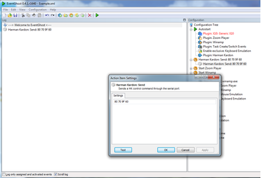

Hello All,
Hope someone's still watching this thread. I added the plugin to use my Harman AVR 247. Plugin installed successfully. Plugin set as COM1, Baudrate at 38400, Number of bits 8, Parity: No Parity, Stopbits: 1, Flow control: None, Generate events on incoming data unchecked.
When I execute 80 70 9F 60, to turn it off, nothing happens.

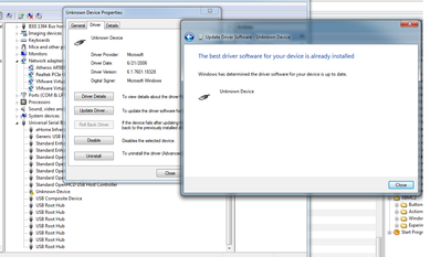

just a few updates on my last post, this is how usb to serial appears on my system.

Hello. I changed to a different Serial to USB cable, no more ! on my devices. I followed instructions by another to set baud rate to 38400, and still it wasn't working. I have "HK" as prefix set.
When I send commands, it's not responding to it. When I turn off or on the receiver, no events is logged in the window.
I then replaced the serial to usb with a serial cable, from HK's rs232 connected to my pc. Still, no event is being logged whenever I do a power on and off.
Hope someone can help.
