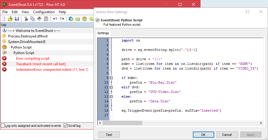

Hi kgschlosser, thanks for the response, I get an error:
Sin┬®erely yours, Neytrino.
Re: How to check if folder exists
you have to remove the 4 spaces in front of each line. sometimes a copy and paste does that
