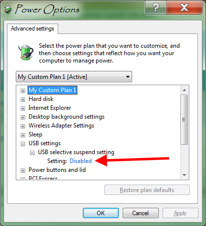

ok to make sure we are all on the same page here

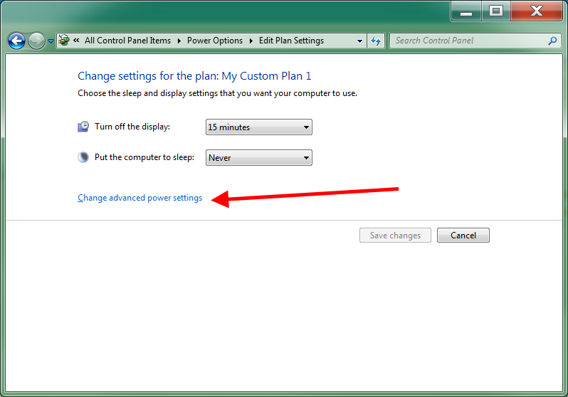

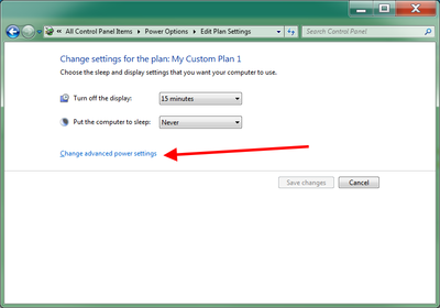

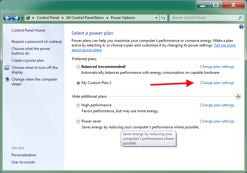

go into your Power Options in control panel
then click on change plan settings for the power plan you have chosen
in the next window click on change advanced power settings
then under the usb settings change the selective suspend to disabled
then go back to control panel and go into device manager

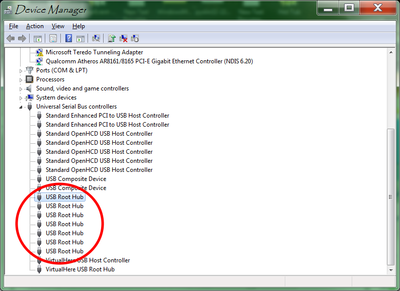

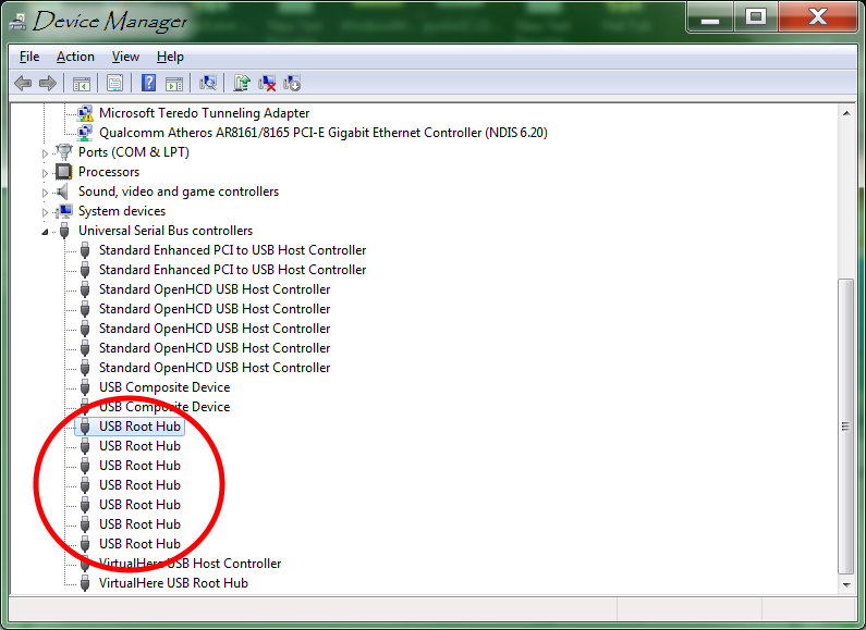

under the universal serial bus controllers

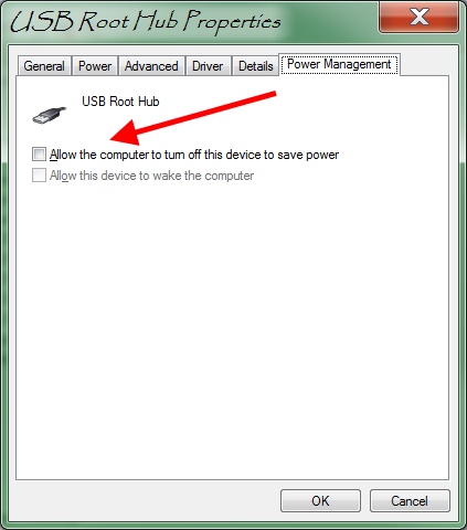

you will have to do this for each of the USB Root Hubs shown. but you need to go into the properties
under the power management tab uncheck the turn off device to save power
this will make sure the usb is not getting shut down. because even if the computer does not sleep windows will still shut off power to it.
