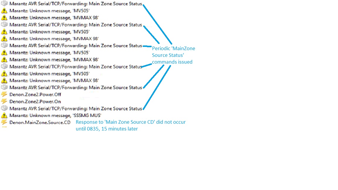

I've just barely scratched the surface, but wanted to give you what limited feedback I have. You probably already know about most of this.
Receiver changes volume in 0.5 dB increments, so 47.5 generates an "Unknown message, 'MV475'", whereas 47 gives an expected event.
"Unknown message, 'MVMAX 98'" is generated for nearly every volume command. Not in the spreadsheet; appears to be another undocumented event. Unknown 'CVEND' also occurs frequently. That appears to be a valid response to CV?, although I didn't issue that command.
Biggest problem appears to be that responses are getting bottle necked somewhere along the way. Some events are coming out asynchronously to the commands. As example, command is "Main Zone Source DVD", repeated once, then multiple commands of "Zone 2 Auto Standby Status". Each of these status commands generates a single non-sequitur response. The event for "MainZone.Source.DVD" doesn't occur until after many intervening commands and responses. Another example, "Main Zone Volume Status" issued multiple times in a row. Expected response for the first two, then more non-sequiturs. Finally, the Auto Standby Status spits out from many commands earlier: Issuing a command that requires an input yields a traceback error.
The good news is that the main functions work. It's just some of the oddball responses. Lots more to check.

OK #1 thing is that you have to remember that if you issue a command the AVR may perform multiple functions... depending on what it's doing..
so as an example...
you changed the volume... and what happens when you change the volume.. it gets louder.. and the AVR may make some adjustments to things dpeneding on what equipment you have so if it detects distortion on a specific channel it may drop the volume for that one specific channel.. who knows! LOL
and CV is Channel Volume
and CVEND is the end of that..
You will get events for Everything..and I do mean Everything...
now an event is something the AVR may just spit out at any random time for absolutely no reason... well it would appear this way... but while the AVR is on it does internal things and checks on the various states... Like source inputs and things of that nature... That data storage i mentioned a couple of posts ago is the solution to this... because it will store anything that has come out and if it has changed then it will process and event...
yeah I know about the volume as well... dumdum's that made the API sheet put MV** as the event not MV***
and we may find more of this IDK
so this is how it goes...
you have a COMMAND... which is what you send to the AVR. and by doing that it will cause the AVR to generate a RESPONSE. But you also have EVENTS that the AVR will produce these come out at any time.. so for example... if you walk over to you AVR and turn the volume knob or change the input... you did not send a COMMAND to the AVR so it will not generate a RESPONSE. but you will however see that there are events that happened.

I don't think I described the problem well enough. I understand that the AVR can generate many events from a single action and that they may spit out at any time, and the power of events to trigger other actions. What I'm observing is a VERY LONG time between a command and its response. For example, after the AVR had been left alone all night, I issued a "Main Zone Source CD" command at 0820 this morning. The events that followed were the results of the Zone2 Standby Status commands issued over 9 hours earlier:
Now, since the change to CD input didn't show the expected response, I started issuing "Main Zone Source Status" commands every few minutes. The acknowledgment of 'MainZone.Source.CD' did not occur until 0835, 15 minutes after the command was issued.
I don't know the source of these delays; I'm just reporting my observations. I suspect that the problem is cumulative. It doesn't seem to happen right after the plug-in is started, but gets worse with time.
The spreadsheet I provided is the current version, updated on July 15, 2016, as it covers the 2016 x300 receiver models. I have a AVR-X3200W (x200), a 2014 model, with updated firmware. Attached is the prior version, dtd July 8, 2014.

let me hammer out the debugging bits and create that storage. and i will send that up to ya. i need to figure out what's going on with this thing...
because what it seems you are telling me is that this thing is and from the images is that it's firing off it's own actions. idk how or why it would do this. but even more so i do not know how it would show up in the log if it was.
and also you do not have to do screen shots all the time...
turn on the time stamps for the log and copy and select the log entries and paste them
