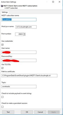

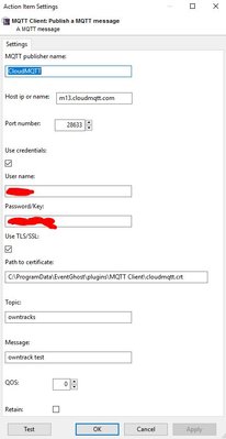

Re: MQTT Client
New version available: Added support for username & password/key authentication as well as for TLS/SSL. Now you can also use those cloud services hosting a MQTT Broker. The setting dialog's have fields for credentials and certificates. The examples below are from my own settings for connections to CloudMQTT. For more information about CloudMQTT and how to set up a plan and configuration, see here: https://www.cloudmqtt.com/
To upgrade from previous version:
a) Download & install the new plugin (MQTT Client.egplugin)
b) Shutdown EG
c) My personal choice if I have many existing MQTT actions defined is to edit the EG xml file. Find all lines starting with "MQTTthreads.MQTTclient" or "MQTTthreads.publishMQTT". What you need to do is add a number of parameters to each of those lines. Typically they shall look similar to below after you have modified them
MQTTthreads.MQTTclient(u'CloudMQTT', u'm13.cloudmqtt.com', 18633, u'owntracks', False, '925453717962', False, True, u'username', u'password', False, u'')
MQTTthreads.publishMQTT(u'CloudMQTT', u'm13.cloudmqtt.com', 18633, u'owntracks', u'ownt test', 0, False, '410083033128', True, u'username', u'password', False, u'')
When you do not use credentials it could look like this:
MQTTthreads.MQTTclient(u'1wire', u'192.168.10.240', 1883, u'/1wire', False, '743893203818', True, False, u'', u'', False, u'')
d) Save and start EG
e) Alternatively you can just delete and recreate all actions once you have restarted EG with the new plugin installed
I have created and included a certificate for CloudMQTT to use when you need a secure connection to the broker. It might be that you have to change the proposed path in the settings. Also remember to use the SSL port if you enable the TLS/SSL support.

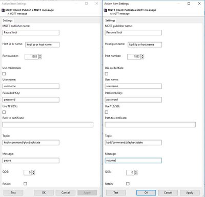

How would you create the pub -t (publish) topics for this kodi plugin http://forum.kodi.tv/showthread.php?tid=222109 with the mqtt client? I did the subscription and I get the data coming in to EventGhost but I can't get it to go the other way back to the Broker. Can please show examples of say; stop,play, pause.......etc
Regards.
Eman457
Re: MQTT Client
Unfortunately I do not use Kodi but looking at the documentation my guess is that it should look like in the examples below (provided you have not changed the default configured topic prefix kodi/)

Post by eman457 »
krambriw wrote:Hi,
Hello krambriw,
That was so cool of you for that help. Everything was right but you have use the MQTT Broker's IP address for it to work! :mrgreen:
