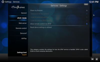

Do you have any of the UPnP options active in Kodi, as that is needed for the plugin to detect Kodi starting.

Any of the UPnP options in Kodis service section needs to be active for the plugin to detect Kodi.

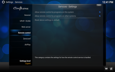

Both "Allow remote control from applications" options need to be enabled.

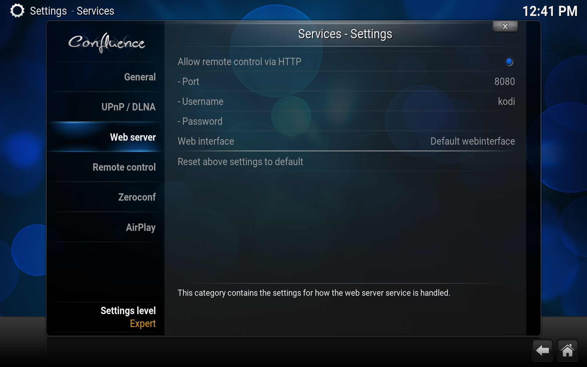

Check that all IP address and port settings match between the plugin and Kodi.

Here are my Kodi settings and I've checked my IP/Port and login name in the EG plugin.
