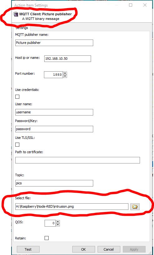

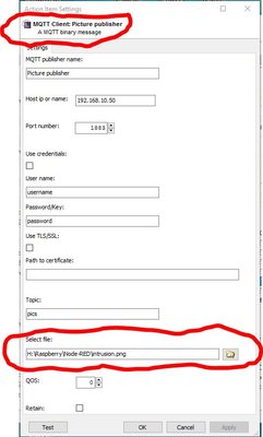

Pls try this one, it supports publishing binary files like pictures. A new action has been added for this purpose
(50.59 KiB) Downloaded 238 times
Be aware that you need an MQTT client that can handle and support subscriptions to binary messages (it will not work using the EG MQTT Client plugin)
Add a new macro/action and configure the action. There is a new field where you browse and select the file
