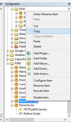

This board is for sharing EventGhost configuration tree's/xml. If you've setup something in EG that you think would be useful to others & you feel like sharing. This is the place to do it. EventGhost uses xml to store your tree's configuration. This can be directly copy/pasted within EventGhost. To get the xml for a macro/folder, you can right click on the item and choose copy(not copy as python).
