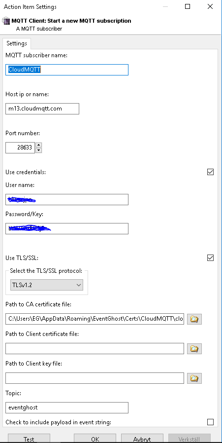

I use EG version 0.5.0 rc1 but I think it should work ok also in older versions. As example, this is my setting connecting to mycloudmqtt using username, password and a single certificate
BR Walter

krambriw wrote:And you did remember to copy the paho folder to lib27/site-packages ??? (If you did not delete the old one manually, it is still there and a newer version is included in the 1.2.0 plugin)
BR Walter
