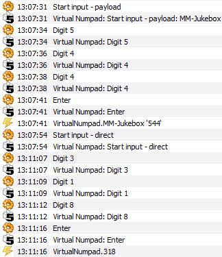

Based on the theme of GBWebmaster I created a plugin, which can generate events with a numeric string.
The number may be either as a suffix or as a payload event. In the second case, the user can define the suffix event itself.
Example of configuration: Result in Log: You can approve committal of this plugin to SVN ?
Virtual Numpad is obsolete and no longer being developed. Instead, use the plugin Multitap: http://www.eventghost.org/forum/viewtop ... f=9&t=1024

Hello Pako,
with the first version of your PlugIn I type the number and the makro with the eventname "123" starts. The same happens, when I use the new PlugIn with the command "Virtual Numpad: Start input - direct".
Why does my makro "Load Playlist by Filter." not start with the eventname "123", when I use the command "Virtual Numpad: Start input - payload: MM-Jukebox". It also didn't start with the eventname "MM-Jukebox.123". What's wrong?
GBWebmaster
GBWebmaster

Re: Virtual Numpad
Hi GBWebmaster!
Actions in the plugin MM is meantime unable to work with payload. Therefore you have to do a separate macro for each album.
Look at the attached file.
This is how it should work.

Hello Pako,
exact this eventname (MM-Jukebox.544) doesn't work.
GBWebmaster
But it's no problem, because your first version do all I need. Thanks a million!GBWebmaster wrote:Why does my makro "Load Playlist by Filter." not start with the eventname "123", when I use the command "Virtual Numpad: Start input - payload: MM-Jukebox". It also didn't start with the eventname "MM-Jukebox.123". What's wrong?
