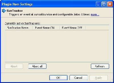

Yes, the installation should be that simple, just make sure you have the __init__.py and the two .png files that are in the .zip file placed in EventGhost\plugins\SunTracker\ directory.
Do you get a window that looks like this when you configure the plugin? If so, have you tried adding the suntracker action/macro, and if that does not work what errors exactly are you getting?

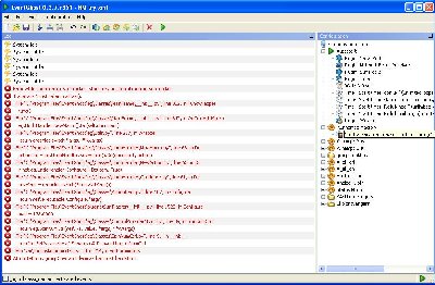

yes, I do get that screen. Then try to add a macro with SunTracker, and that's when the error lines pop up.

am trying to attach a file that shows the errors, but somehow even that is failing. Must be one of those days.
It keeps telling me "extension not allowed". Have tried docx, doc, and rtf.....

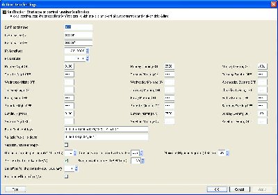

Here, try this version.
Seems like one setting for the SpinNumCtrl (the number boxes in the config dialog) is conflicting with some settings that are normally fetched from the locale. Probably the original author of this plugin did not happen across this problem since it works without modifications in his locale (as it so it happens works fine in my locale also).
-> groupChar = ' ',
-> decimalChar = '.',
Have to be different from each other.. I set groupChar to an empty space in this case.
That should be another bug squashed, thanks for your efforts!

Yes, when I open the macro it now gives me a complete screen with fields to fill in... phew, that's a relief. At least I got my sanity back, was beginning to think I lost my mind.

I'll attach a snapshot of my config screen.

Figured it out.... I swapped latitude and longitude.... :shock:
It now comes up with the right rise and set times.
