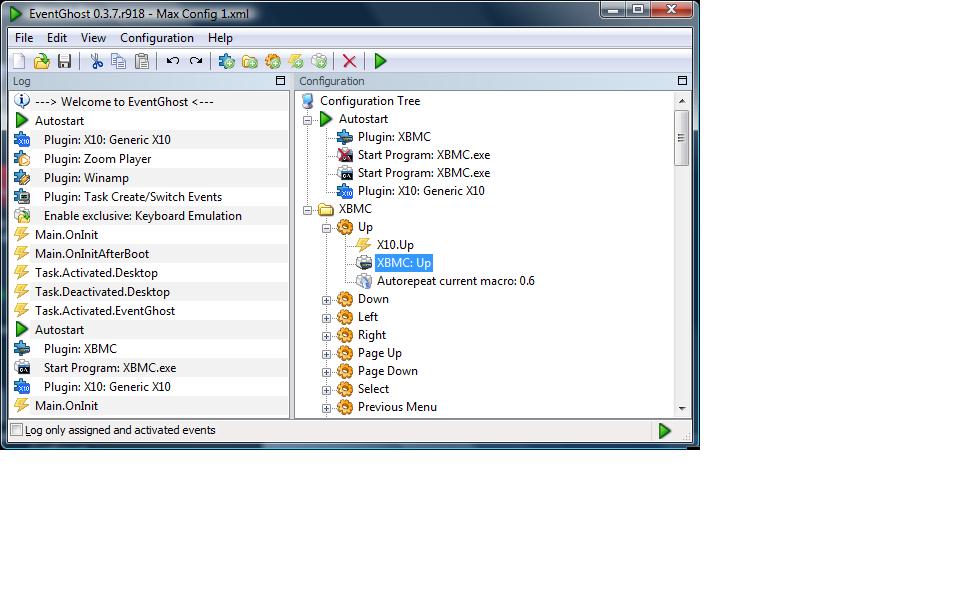

I was able to configure my remote and to launch XBMC without any issue.
The question is: can I change the meaning of an action (for example X10.Ok) depending on the status of XBMC?
I mean on the main menu OK must select but if I'm playing a video OK should show the cross menu.

[quote="kricker]
example:
in EG:
remote button "ok" => keyboard command "enter"
[/quote]
kricker
it is not clear for me what it means keybord command enter.
If I use the plugin I have the XBMC: actions not keyboards.
in the picture you can see the config.
Or I'm using it in the wrong way?
thanks for your help.
kricker
Posts: 147
Joined: Thu Oct 12, 2006 5:49 am
Re: XBMC
Post by kricker »
You don't have to use the XBMC event action, you can send a system keyboard "enter" instead. Or use jonib's plugin which has keyboard actions as well. If you use the XBMC event action you can not make it do different actions (cleanly) based on what screen you are on. The event actions are direct commands to the XBMC event server. You could give a remote button 2 XBMC event actions, but it will always send both actions to whatever screen you are on. You might want to read up on what the event actions are. ;)

mfsav2
Posts: 9
Joined: Tue Apr 28, 2009 11:00 pm
Re: XBMC
Post by mfsav2 »
thanks for the explanation... now is clear :)
I just have some issues to understand well all the options in the xml file.
regarding the plugin is not part of the EV setup?
