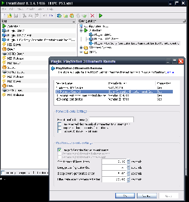

I still have no Sleep / Hibernate
I've installed the Widcomm 5.1.0.1100 Drivers and installed the patches. (to allow sleep command)
I've gone back to V 0.3.6.1486 of eventghost (to accept the following)
I've put in the v3.0.1 of the plugin (which enables the sleep command)
Should this work?
I still see no events in eventghost wth sleep or hibernate, Everything else works but batteries are not holding out long enough

uncola
Joined: Wed Jul 01, 2009 4:36 pm
Re: PlayStation 3 Bluetooth Remote
Post by uncola »
I'm using build 1066 with the ps3 plugin version that's built into that.. it says it's version 3.00, but when you go to the add plugin screen and click on ps3 plugin, the info panel on the right says it has the new power saving sniff mode. so I think it must be some newer version. I'm using the script from the OP of this thread.. I added some keys.. I think the power saving is built into the plugin because I haven't had to change batteries yet.. dunno if there's a way to manually initiate sniff mode

4list4ir
Joined: Mon Jul 06, 2009 3:17 pm
Post by 4list4ir »
Magao...
1.Should the latest Eventghost work with sniff mode?
2.Should I be seeing an event in the log when the hibernate/sniff mode occurs?
(Am I supposed to be seeing HID.Hibernate?)
I'm masuring the current flow on he remote with a DMM and i've not seen it drop, after any significant wait.
What is supposed to be happening to save power?
Regards
Ali
magao
Posts: 21
Joined: Sun Nov 09, 2008 11:06 am
Post by magao »
It's been a while (as I said earlier in the thread, I no longer have a PS3) - I've had to go back to the source.
It takes effect on HID.Hibernate (and I just realise it only takes effect on HID.Hibernate - it doesn't bind to the correct event if you change the event prefix). So if you're not seeing HID.Hibernate at all, then there must be some activity from the remote before the hibernate period (which is set in the config). Make sure you're watching all events, press a button on the remote, and then leave it alone completely for a minute or so.
Of course, if you don't happen to have the Widcomm drivers installed, you won't get SNIFF mode even if you do get the HID.Hibernate event.
