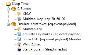

I added in a section to call a Batch Command program using Multitap that would allow me to
setup a pseudo sleep timer. The arguments for running the sleeptimer.bat file were the same
{eg.event.payload} used to call the OSD showing the selected # of minutes.
The Batch file then sets a delay based on that time selected and issues a command line sleep message.
Here is a snippet of the config:
Now here is my question...
When Media Center is running, the OSD screen is not shown.
Is there a simple way to add this in??
