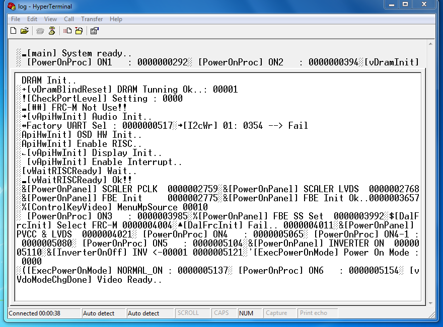

I have some problems, as In the tv doesn't do what the plugin wants it to do or as it doesn't do nothing .
I soldered my own cable according to the diagram posted, (though it wasnt clear if the pin numbering was from the soldering pins or from the connector side). I interpreted it as from the soldering pin side.
The cable was to short, though I had an old cable laying around as I used for extension, it could be that cable or the soldering that messes it up but I get the debug in hyperterminal when powering on the tv so atleast something is right. I have a samsung A series lcd, 2008 something
Any suggestions on how I could make this work?
I'm guessing the cable is correct as I see the debug in hyperterminal
lappen
Re: Samsung TV's
I resoldered the cable by the pin"out" instead, last try was pin"in".. Seems I don't even get a connection with the TV now so I guess the plugin only works with the newer samsungs tv's :/
