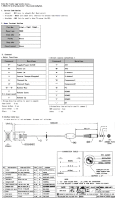

Plugin for Samsung Televisions:
RS232 Cable: Samsung DCR003G RS232->stereo mini plug for "ex-link" port
Commands that accept an argument don't work (will fix after turkey day weekend)
Commands that have no argument should all work.
* File Updated Nov 27 *

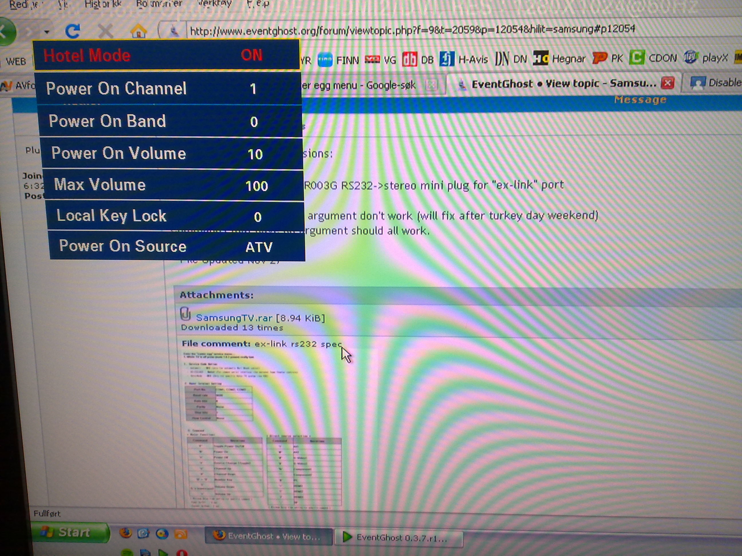

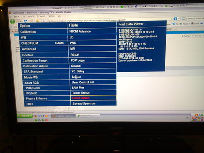

Hi.
I have a Samsung LE46A856.
I have made the cable.
When i press mute "1, 8, 2, power" it only goes on. If i press "Info, Menu, Mute, Power" i get to a service menu.
I tried turning hotel mode to on but it doesent work. Should i do something else?
Have atached images with the menues.
