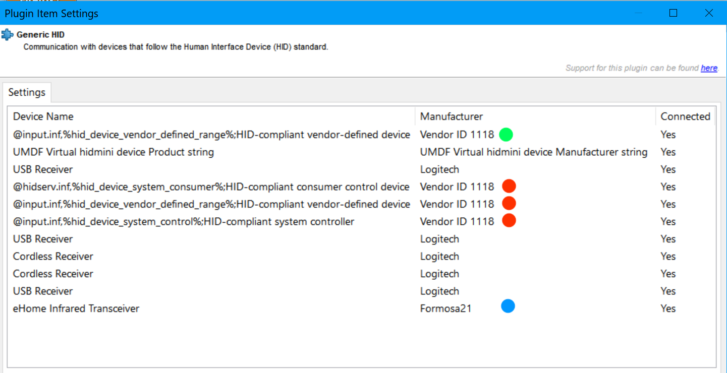

I get the same problem for that JRMC plugin but its probably easiest to take this one step at a time. If you installed just one HID device, try installing other HID devices with a similar name. I have 4 @hidserv devices on my machine, and I'm curious if you get the same on yours. Out of curiosity, what are you using as an IR reciever? is it a standard MS ir receiver or a Harmony reciever. In a nutshell, you need to add the HID device those IR commands get sent through in order to see them in your EG log. If you can make a screenshot of all of your HID devices that come up when you add that plugin that would probably help the most. We can get around the JRMC plugin not working for the time being by emulating keystrokes

What other HID devices are grouped next to the @hidserv devices? Honestly you might be able to keep adding devices one at a time until you start seeing HID codes. This isn't the preferred method but it could help you narrow down which device generates the codes you want. Aside from me seeing the names of the devices you get, its a matter of us guessing which HID device to add that generates a unique code.

Re: Help with getting MCE working and Add keyboard shortcut
Item with GREEN dot produces long codes.
Items with RED dot do not produce any codes.
Item with BLUE dot gives error starting device and produces no codes.
Other devices are wireless mouse.
