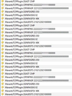

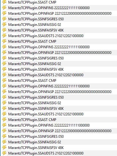

what's odd is the things you show in the screen shot have absolutely nothing to do with the plugin. i just skimmed it really fast but none of the events look anything like the data in the API.
there are no commands or responses that begin with SS or OP. did you happen to have the android app connected at the time this was happening??
I am wondering if these are messages generated from that.
and as far as the HTTP method. there isn't even 1/4 of the available commands that are available from IP/serial.

kgschlosser wrote:what's odd is the things you show in the screen shot have absolutely nothing to do with the plugin. i just skimmed it really fast but none of the events look anything like the data in the API.
Yes, you're absolutely right. Those events only occur when the app is connected.

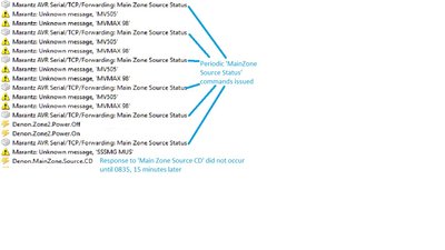

I've just barely scratched the surface, but wanted to give you what limited feedback I have. You probably already know about most of this.
Receiver changes volume in 0.5 dB increments, so 47.5 generates an "Unknown message, 'MV475'", whereas 47 gives an expected event.
"Unknown message, 'MVMAX 98'" is generated for nearly every volume command. Not in the spreadsheet; appears to be another undocumented event. Unknown 'CVEND' also occurs frequently. That appears to be a valid response to CV?, although I didn't issue that command.

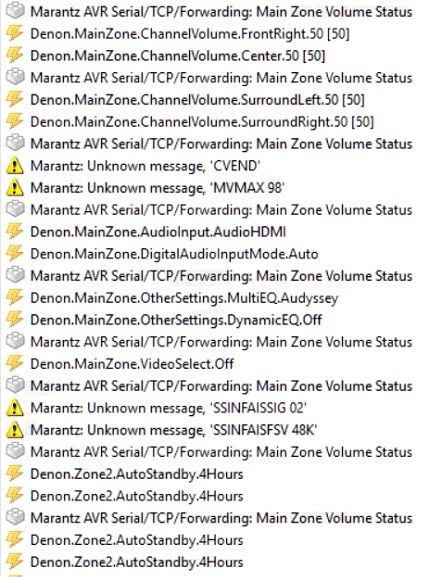

Biggest problem appears to be that responses are getting bottle necked somewhere along the way. Some events are coming out asynchronously to the commands. As example, command is "Main Zone Source DVD", repeated once, then multiple commands of "Zone 2 Auto Standby Status". Each of these status commands generates a single non-sequitur response. The event for "MainZone.Source.DVD" doesn't occur until after many intervening commands and responses.
Another example, "Main Zone Volume Status" issued multiple times in a row. Expected response for the first two, then more non-sequiturs. Finally, the Auto Standby Status spits out from many commands earlier:
Issuing a command that requires an input yields a traceback error.
The good news is that the main functions work. It's just some of the oddball responses. Lots more to check.

OK #1 thing is that you have to remember that if you issue a command the AVR may perform multiple functions... depending on what it's doing..
so as an example...
you changed the volume... and what happens when you change the volume.. it gets louder.. and the AVR may make some adjustments to things dpeneding on what equipment you have so if it detects distortion on a specific channel it may drop the volume for that one specific channel.. who knows! LOL
and CV is Channel Volume
and CVEND is the end of that..
You will get events for Everything..and I do mean Everything...
now an event is something the AVR may just spit out at any random time for absolutely no reason... well it would appear this way... but while the AVR is on it does internal things and checks on the various states... Like source inputs and things of that nature... That data storage i mentioned a couple of posts ago is the solution to this... because it will store anything that has come out and if it has changed then it will process and event...

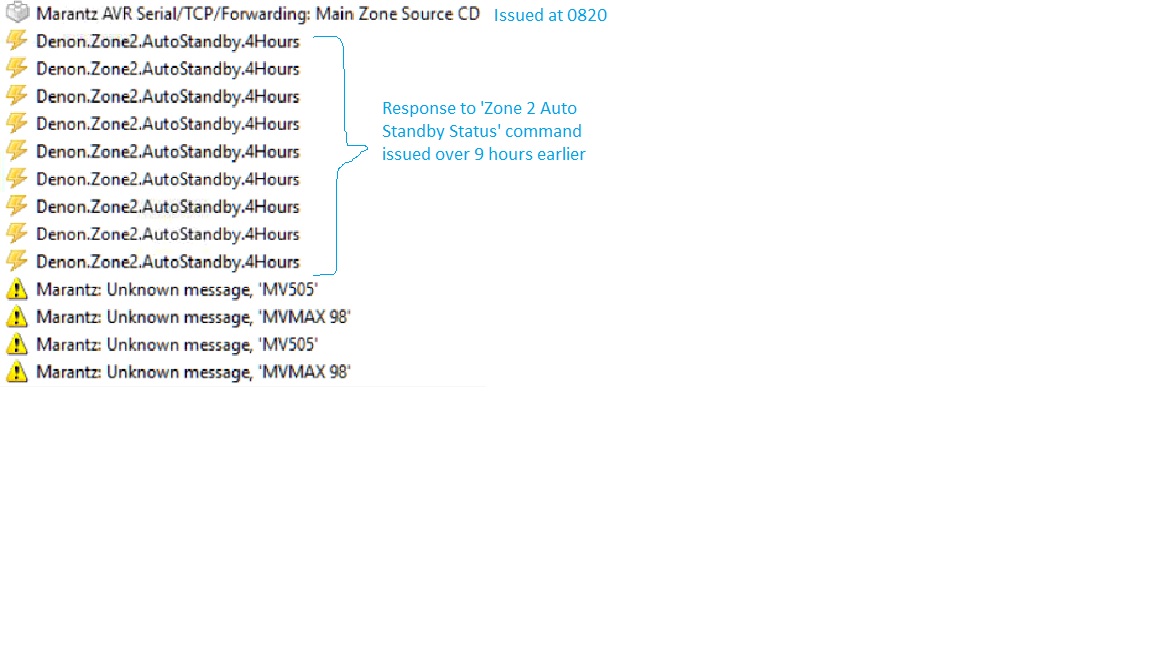

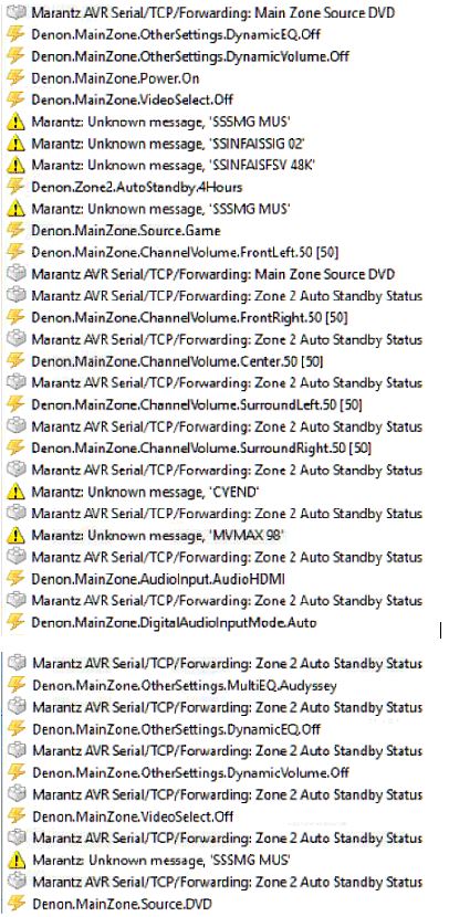

I don't think I described the problem well enough. I understand that the AVR can generate many events from a single action and that they may spit out at any time, and the power of events to trigger other actions. What I'm observing is a VERY LONG time between a command and its response. For example, after the AVR had been left alone all night, I issued a "Main Zone Source CD" command at 0820 this morning. The events that followed were the results of the Zone2 Standby Status commands issued over 9 hours earlier:
Now, since the change to CD input didn't show the expected response, I started issuing "Main Zone Source Status" commands every few minutes. The acknowledgment of 'MainZone.Source.CD' did not occur until 0835, 15 minutes after the command was issued.
I don't know the source of these delays; I'm just reporting my observations. I suspect that the problem is cumulative. It doesn't seem to happen right after the plug-in is started, but gets worse with time.

Re: New Marantz TCP Control Plugin
let me hammer out the debugging bits and create that storage. and i will send that up to ya. i need to figure out what's going on with this thing...
because what it seems you are telling me is that this thing is and from the images is that it's firing off it's own actions. idk how or why it would do this. but even more so i do not know how it would show up in the log if it was.
and also you do not have to do screen shots all the time...
turn on the time stamps for the log and copy and select the log entries and paste them
