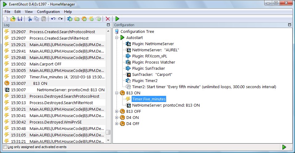

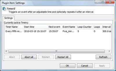

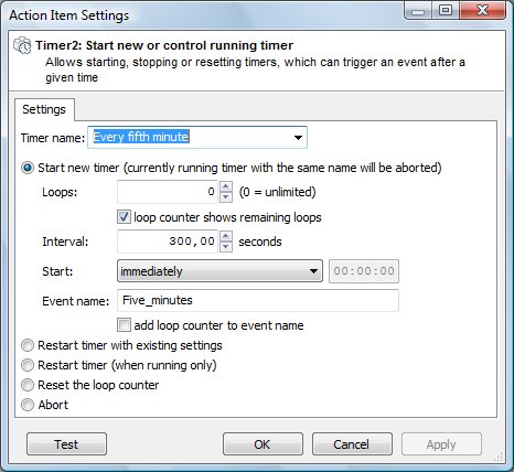

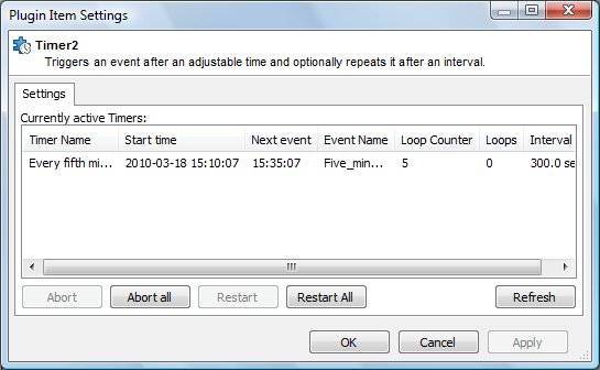

This is a typical configuration for a timer action that works for me in my test set-up
You need to check carefully that it is really running
Once the event appears in the log, copy & paste it (or drag and drop it with left mouse button) to the macro you decide
Next time the timer event fires, it will trigger the macro and the actions inside
