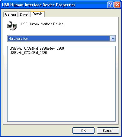

Re: Plugin for USB PC Remote Controller
Ok here is how mine is identified in device manager...I'm using this driver: http://www.eventghost.org/downloads/USB ... Driver.exe (with modified inf file mentioned before)
USB\VID_073A&PID_2230&REV_0200
Also did you install the driver in the HID devices titled DAnschis Ebay Fernbedienung? Mine did not work correctly until I manually installed this driver in the right device. Also make sure to have ignore numlock enabled.. and play with the numlock button until the correct values shows up. The other numlocks will give nonsense values returned.

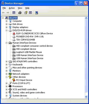

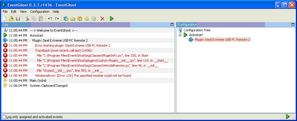

Plugin for USB PC Remote Controller (USB\Vid_073a&Pid_2230)
I have one of those IR receivers from ebay and I can't seem to get it working with eventghost. I tried following all the instructions on this thread, but I probably got it wrong as I am new to eventghost and can not readily recognize what is right and what is wrong.
When I try to update the driver via the device manager by pointing to a driver DLL, I get a message that the driver can not be installed. When I try using one of the driver installers I get a message the the driver was installed successfully but there is no change in the driver shown in device manager. After I copy the PY, PYC, and INF plugin files to the plugin folder, I am able to install the "Deal Extreme USB PC remote" plugin to the start section, but then I get an error messages in the log and no apparent response from clicking the buttons on the remote.
I have spent many may hours trying the different drivers and plugin files linked on this thread, but I can not seem to get this going. Any help in identifying what I got wrong would be appreciated. I attached some pics that might help.

Re: Plugin for USB PC Remote Controller (USB\Vid_073a&Pid_2230)
Are you making sure to use the right device id in the device manager to manually force install the driver? Go into driver details tab and use the pull down to select hardware ID make sure the hardware ID for the HID device matches than do a manual install of the driver.. Just extract the driver to a folder and copy the driver_mod.inf that you should have downloaded from here for the remote 'DAnschis Ebay Fernbedienung' and copy to that folder. You have to replace the original driver.inf file and use that to install the driver. My earlier post has the driver_mod file you need.hkeiner wrote:I have one of those IR receivers from ebay and I can't seem to get it working with eventghost. I tried following all the instructions on this thread, but I probably got it wrong as I am new to eventghost and can not readily recognize what is right and what is wrong.

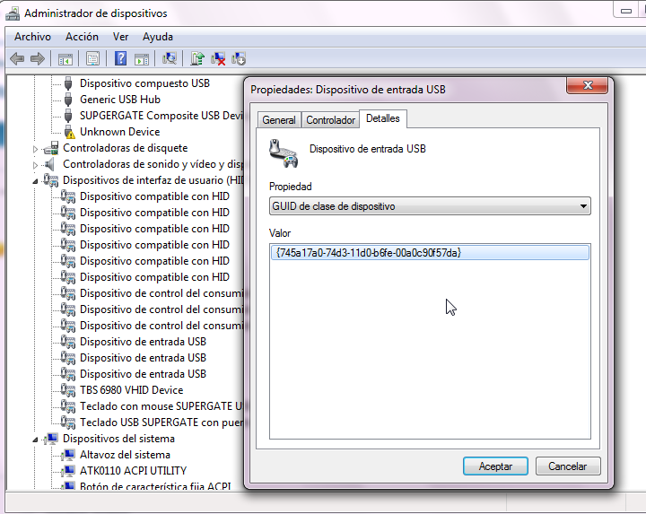

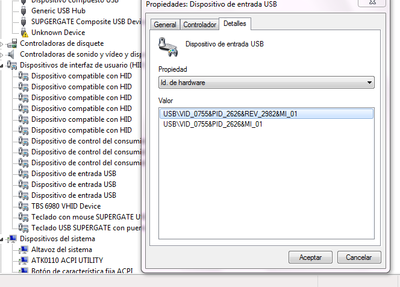

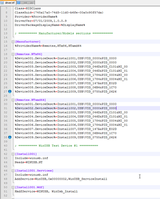

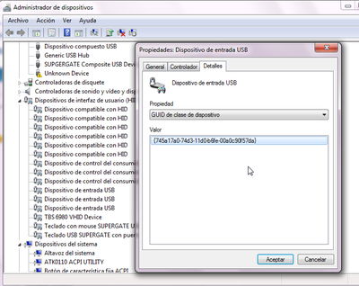

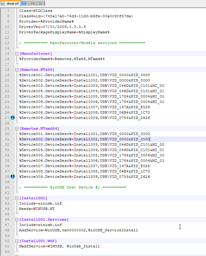

Dear All,
I'm new here, but I've spent many hours already to get this stubborn remote to work properly. As most of others here, when I press buttons on the remote some of them are recognized by EG as keystrokes but some as HID commands.
This is the photo of remote I've purchased the following remote on Ebay:
This is how it is recognized by Device Manager:
I've changed drive.info posted in driver_mod.zip by molitar. Here is the result (I've changed only Hardware ID):
and
put it into a folder with extracted files from http://www.eventghost.org/downloadsUSB- ... Driver.exe
Than I executed DPInst_x86, but nothing changed in recognition of the RC in the Device Manager
What I've been doing wrong? Could please somebody clarify?
OS: Windows 7
EventGhost: 0.3.7.r1436
and
OS: Windows 7
