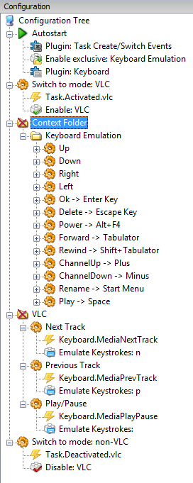

(Edit: I'm also attaching a screenshot of my EG tree: I'd appreciate if you could tell me what branches are unnecessary in my case.)

But nowthat you can see the button presses it's just a matter of creating macros. It might be a good time to read the wiki as well and just generally play around with what you can do with EG, you will get the hang of it pretty quickly.
And about specific instructions for your vlc problem.. well.. just remove all other actions except your VLC ones? If you are using the VLC plugin it connects to vlc's 'rc' interface over TCP/IP, it wont do anything unless it can connect.

jinxdone wrote:Take a look at especially the 'Enable exlusive' action in the EventGhost actions.
Tried the "Enable exclusive" thingie, but I still could, say, type letters in a text file with my headset(!), which is not normally something I'd like to do... Anyway, I'll give your wiki some reading, see what I can come up with.

The issue is, again, to tie the headphone buttons exclusively to VLC even when the VLC window is minimized/not active. I, so far, fail to see how "Enable exclusive" might help.
Is there an "activate/deactivate application" action? Or a "direct (keyboard etc.) input" to a specific application? What's the use of the "Bring to front" action? Is that the same as "activate the application"?

What the 'enable exclusive' action does it enables inside eventghost an folder and at the same time disables all other folders in the same level. It's only used to enable disable stuff in the config and has nothing to do with other applications.
So I take it you have not used the 'VLC' plugin (which uses TCP/IP to connecto to VLC) but rather you want to emulate sending keypresses to VLC.. You can specify to what application you want to send the keypress to with the 'find window' action, use it to target 'vlc.exe' and immediately after that put the 'emulate keystrokes' action.
