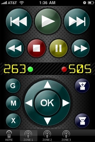

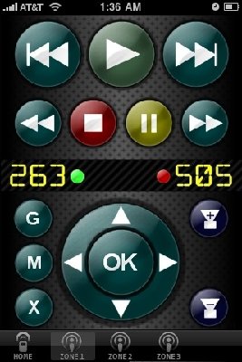

dtv preliminary interface

Had to return my leased laptop back to school at the end of the semester. Backed everything up and apparently made some type of tragic error because I lost most of the work I've done the past month or so on this and other things. Grrrr.
I didn't care for my artwork anyway so I revised my DTV interface. Screen one is above. Second screen gives the rest of the functions.
