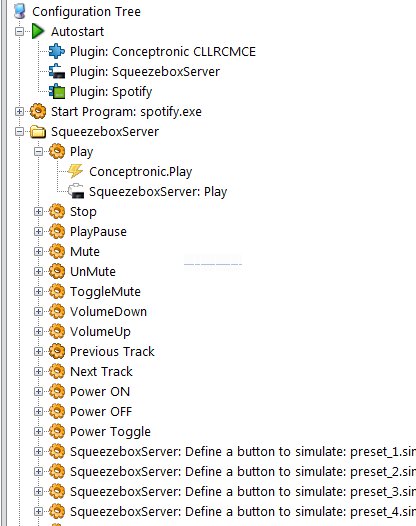

Here is a new plugin for controlling SqueezeBox devices via Squeezebox Server
First thanks to JingleManSweep <jinglemansweep [at] gmail [dot] com> for providing the Python Wrapper
Of course you first need at least one SqueezeBox player and installed Squeezebox Server (or the old SqueezeCenter)
I have in my case made a very nice combination using
- Spotify plugin
- SqueezeboxServer (this plugin)
- Conceptronic RF Remote plugin
See sample pictures below
I have shared the buttons on the remote between the plugins so some controls Spotify and others the Squeezebox. It works really good as I stream music from Spotify to all my SqueezeBoxes :D , having control with one remote "that sends through walls"

Hi thanks for the plugin,
how do you set this up? I have 4 boxes hooked to my server.
eg 0.3.7.1076
Vista, x32, SP1
Re: Squeezebox Server (former SqueezeCenter)
I see two options. Either you configure your sq boxes to play synchronized and use this plugin to control all (same music everywhere). In this case, you can enter the name of any of your sq boxes in the name field
Or you add the plugin a multiple number of times, one for each sq box you like to control (this is possible with the updated version available for download above). Enter in this case the name of each sq box for respective plugin
It is possible to control volume, next track, power on, play, stop, pause etc using the actions
In this updated version I have also added actions for the presets 1-6
