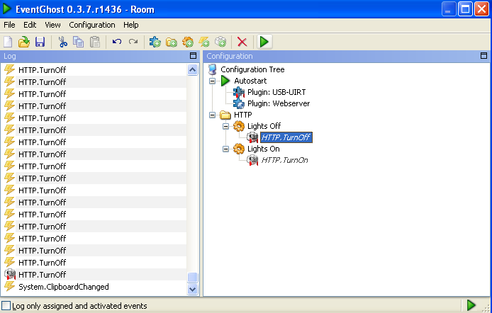

I'm not sure what I'm doing wrong, but if i try to execute this in a webserver: http://localhost:1234/index.html?TurnOff
In the eventGhost log i get HTTP.TurnOff, but with the lightning icon next to it.
My event is called HTTP.TurnOff. When I execute this through EventGhost, in the log section i get HTTP.TurnOff with a different event icon next to it.
I cant seem to be able to execute events from the webserver. any ideas?

drag and drop the lighting event HTTP light off from the log window and drop it between the cog light off macro and the action item light off.

awesome! thank you!
