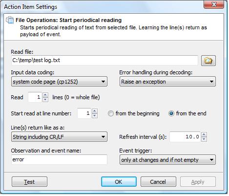

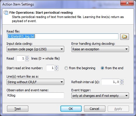

You can very well use the plugin "File Operations" and his action "Start periodical reading":Once into the file is writed a new line, is released an event that carries a payload.
Payload is content of a new line.
Just then write a simple script that will scan the contents of payload.

You must use the action "Abort periodical reading" or "Abort all periodical reading"ijourneaux wrote:If or disable it, it stll keeps running. see attachment. i disabled the plugin and stll got an event
Please download a new version of the plugin "File Operations" from the SVN. I was there did a very simple but important improvements. Now you can write (like file to observation) not just a specific file, but also a Python expression (such {eg.result} or {eg.event.payload}).ijourneaux wrote:- how would i monitor the newset log file in a directory? in my case the log files are xxx2010-4-12.log, xxx2010-4-11.log, etc. I only need to monitor the latest one
An example of a script I can write you, but I need an example of content logs.ijourneaux wrote: i am still getting my feet wet with eventghost? are there any examples f creating a script similiar to what i need to analyze the payload from fileoperations?

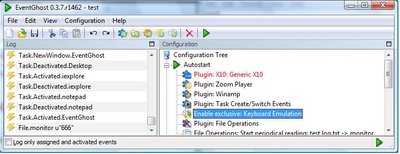

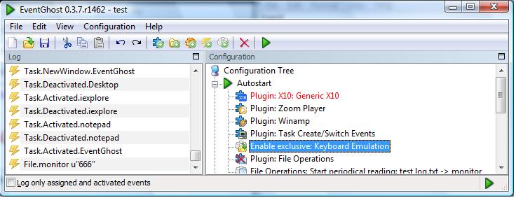

Re: Monitor log file for error
I do not understand, because of these problems, I concentrated and many times I've tried.
Please set EventGhost as shown in the picture:Then do the same test as before and copy here the contents of logger.
Please do the same with both versions of the configuration.
It is possible that you did not configure all the necessary adjustments. So please attach both your xml files.
