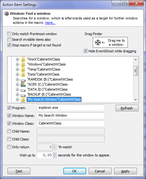

Findwindow / use PID to track a window that changes name?
Post by Roamin »
I'm looking for a way to track the same window, now the problem is that the process is explorer.exe . I have set events so that when a specific remote control button is pressed, either my Videos library or my Music library is accessed via windows explorer. Now regularly i would just use findwindow, along with wildcards to isolate the window I want, but I cannot do this with Explorer , as there is at least one always running, the windows desktop. When i browse my libraries, the window name constantly changes, making the findwindow, in its current form, unusable. Is there a way to implement findwindow, to find a window according to the PID ? Although i may have many explorer.exe running in my process tree, they all have a different PID, which i could use to track the same explorer that was first launched, and use it to regain focus on that window, allowing to keep browsing my libraries. Now, it might not be possible to simply reuse the same explorer to return to my "root" folder of my libraries, as i would have to pass the correct folder argument to explorer while its running, rather then while its launching, but i would still use the PID to terminate the old explorer, and relaunch it pointing to the "root".
So basically, i'm looking for a way to track the windows based on their PID , because the window name completely changes, and no wild cards can help.
On a side not, i found the updated __init__.py in another thread (for the window plugin, move absolute) , while looking for more options of findwindow, and although i have done the same thing using the registry to detect if my 2nd display was active, the devs should include in the the latest release of EG.
Thank you.

1) In the first step you normal way will find a window. It is the action Find Window:
2) Do you need to know and remember the PID of this window. This is done in Python Script action.

3) Title of your window changes and you want to find it by PID. This is done in a macro "Find Window by PID" using Python Script action.
from eg.WinApi import GetWindowThreadProcessId, GetWindowText
findMyWindow = eg.WindowMatcher(u'explorer.exe', None, u'CabinetWClass', None, None, None, False, 0.0, 0)
myWindows = findMyWindow()
for hwnd in myWindows:
    if GetWindowThreadProcessId(hwnd)[0] == eg.globals.myPid:
        eg.plugins.Window.FindWindow(u'explorer.exe', GetWindowText(hwnd), u'CabinetWClass', None, None, None, False, 0.0, 0)
        break
4) Now you found a window and you can manipulate it. In this example, it is the action "Bring to front"

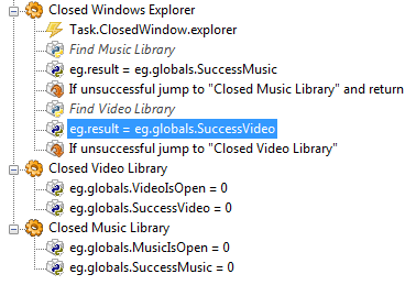

Thank you very very much Pako! I've used what you showed me to do all that i wanted to do. I can now keep track of every single explorer.exe i launch, pressing the same button will either launch a specific windows explorer, or bring the already existing one to front. Also whenever a windows explorer closes, I look to see if the ones i'm keeping track of are still open, if they are closed, next time around my button press will launch them again. This is exactly what i was trying to do :).
Although everything is working perfect, i have a question on how things are done. Now i currently do this :
eg.globals.SuccessVideo = 0
    if GetWindowThreadProcessId(hwnd)[0] == eg.globals.VideoPid:
        eg.globals.SuccessVideo = 1
        break
    else: eg.globals.SuccessVideo = 0
And next I do the simple python command :
eg.result = eg.globals.SuccessVideo
But is there anyway to make the actual python function return a value?

Re: Findwindow / use PID to track a window that changes name
Now I see better what you need.
I think it is better to do something like this:
pids = [eg.WinApi.GetWindowThreadProcessId(hwnd)[0] for hwnd in myWindows]
if "MusicPid" in eg.globals.__dict__:
    if not eg.globals.MusicPid in pids:
        eg.TriggerEvent("ClosedMusicLibrary")
if "VideoPid" in eg.globals.__dict__:
    if not eg.globals.VideoPid in pids:
        eg.TriggerEvent("ClosedVideoLibrary")
I can not try it, but I think it will work.
BTW: You can directly assign a value to eg.result inside in the script :

Thanks once more Pako! I modified my event sheet to use your method and it works just as well, but with fewer statements so it should be more efficient. I'm still proud i had managed to get it working without asking too much. I guess the reason assigning eg.result inside a python script wasn't working is the condition i was testing was probably bad, and only ever giving me 1 answer.
