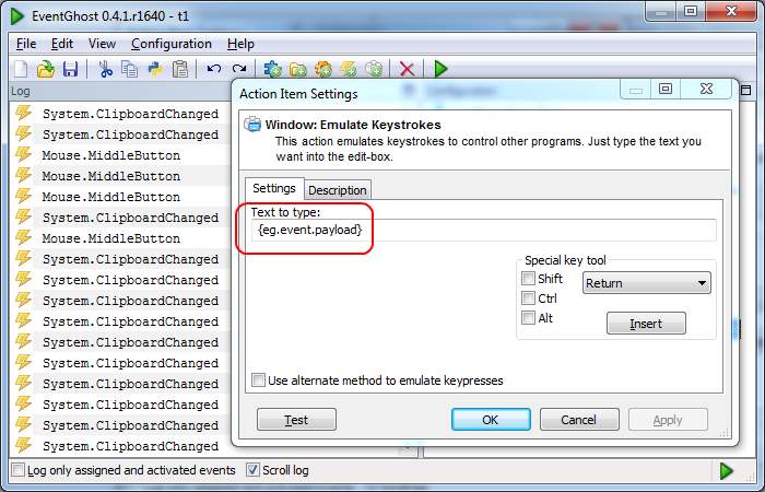

Re: Emulate keystrokes is a variable possible
Dear rekinnect,
I think that I understand your problem and the use case. Even if your original posting is from 2011, I want to put in what I have figured out today, after searching quite some time. I think that this will solve your problem.
My use case:
So, if I receive an event with a payload I can call the "Emulate Keystrokes" Action from Category "Window -> Emulate Keystrokes" and enter in the field "text to type" this string:
Enter this with the curly brackets as shown in the screenshot I posted below.
If the message contains ...
... the "Emulate Keystrokes Action" will use this information to perform the keystroke as if you entered it manually in the configuration dialog.
This is how you can specify the keystroke action after having set up the rules and spontaneously decide what they should do.
I hope this helped somebody, as it was a little hard to figure out myself as I am a very to EventGhost.
By the way, my project is to use my Android tablet as a dashboard for an game called "Vendetta Online" which has quite some commands that I don't want to memorize. So I create with Tasker (1) (2) a simple user interface (Tasker calls them "Scenes") with buttons labeled with the function they call. On pressing the button the "AutoRemote App" is triggered and sends something like the above "{Alt+x}" to EventGhost, which will send this to the game. (At the time of writing this, I didn't get there, so I don't know yet, if "Vendetta" Online will accept these keystrokes.) The buttons will call the same Tasker task but with each a different payload string. Therefor I do create a button with the specified string on my tablet and not in EventGhost. I might do it the other way around, but I prefer writing "code" instead of clicking around.
{eg.event.payload}If the message contains ...
{Alt+x}
