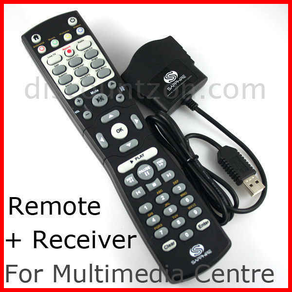

I bought remote in ebay . Like Cyberlink, but with Sapphire label. Evenghost identified it as CyberlinkUniversalRemote.
After some time has stopped working autorepeat and sometimes did not work the DVDMenu button.
I rewrite plugin for CyberlinkUniversalRemote. Now everything is working properly.

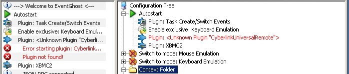

I wanted to try your file __init__.py but I suppose some compilation is needed because the plugin is no more recognized when I replace the original file by yours ?
If you could briefly describe what I have to do to try your file ...

There is no compiling necessary. All I did was replace the __init__.py file in the Program FilesEventGhost\plugins\CyberlinkUniversalRemote directory. I used the second file that was posted.MengWan wrote:Hi,

I have the 0.1.4.1.r1568 Eventghost, if I replace in EventGhost\plugins\CyberlinkUniversalRemote __init__.py by the new one, I get a message on the "log" (left pane in EG window) that tells me the plugin is not found !
I suppose this comes from my definite newbie status, that "py" files should get compiled in a "pyc" one, but the existing "pyc"'s time stamp does not change so there could be a problem with the whole thing ?
(I tried to remove the "pyc" file, and it gets reconstituted when the original "py" file is present)
Is there a way to have a more verbose mode to see what's happening ?

It compiled automatically on my system. I don't know if it will work but I attached my .pyc file you can try. I am running Windows XP SP3 as well.

Thanks for your help, but it does not change anything ...
I reaffected "Power" and "DVDMenu" to "Clear" and "Num0" and it works perfectly for the moment !
