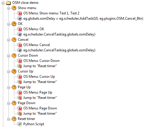

Re: Close OS Menu after a delay
If you are uncomfortable mentioned disadvantage, you can do the following:
Python Script:
eg.scheduler.CancelTask(eg.globals.osmDelay)
eg.globals.osmDelay = eg.scheduler.AddTask(10, eg.plugins.OSM.Cancel_Btn)

themaster1
Posts: 133
Joined: Wed Feb 03, 2010 9:02 pm
Post by themaster1 »
I tried your python commands Pako without luck. Do i need a plugin or something ?
No, do not need anything else.
I do not see why it would not work.
However it is clear that it can work when you're going to control the menu using the keyboard.
It is necessary to control it using the prepared actions.
In the example shown, however, are no events.
You must complete the required events (of course it depends on what you have remote control).
themaster1
Posts: 133
After further testing it is working. It seems you have to put each command right after OS Menu show menu / Cancel. The problem was that i have things after such as Find window OS Menu; bring to front or enable Context folder.

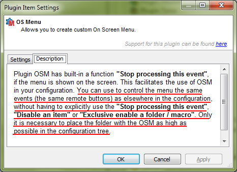

I think the solution is very easy. Just read the description of the OSM plugin and act accordingly.
