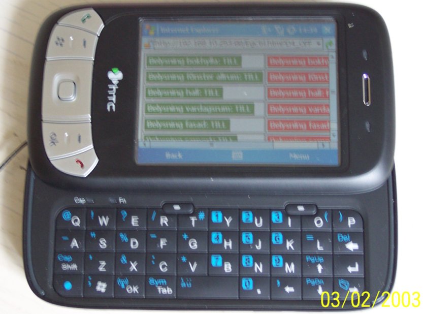

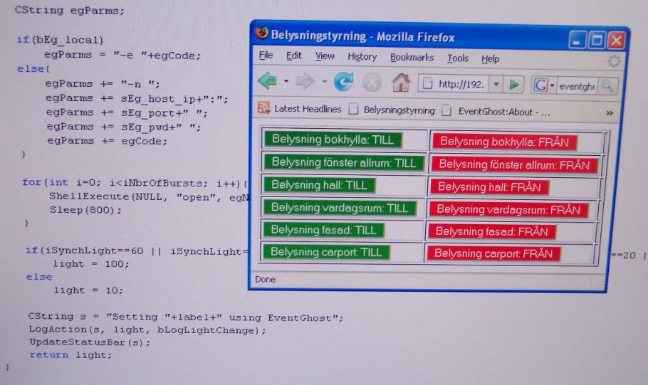

Below are screen shots of my small html I use to control indoor and outdoor lights of my house. Besides manual control through the GUI, I have a separate application that sends triggers for the outdoor lights to EG by calculation of local sunset/sunrise.
Everything works perfect according to my needs!
To do the same, you need to add the web server plug-in, configure it and create your macros, actions and events. Then take my sample named "EgCtrl.html" and edit accordingly. Put it then in the web root.
You can see that my EG events are named like D1_ON, B1_OFF etc and typically you navigate with url's like ...EgCtrl.html?D1_ON
The code is really simple and easy to change if you need other/more buttons.

The first picture is just to demonstrate when I control the lights from my smartphone. I have tried it over internet as well and it works of course but for security reason this is now disabled.
The second picture shows the small window on my laptop screen with the browser pointing to the EG webserver.
