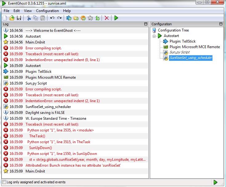

Now to my issue. I don't really know how to install the script. I downloaded your Nov 03 version, added a Python Script Action in Autostart and copied/pasted everything from the .py file. Perhaps it should be done in another way?
When I execute the script (with F5 or restart EventGhost) I get the following errors logged:
15:43:29 Traceback (most recent call last):
15:43:29 Python script "0", line 3535, in <module>
15:43:29 TheTask()
15:43:29 Python script "0", line 3515, in TheTask
15:43:29 SunUpDown()
15:43:29 Python script "0", line 1550, in SunUpDown
15:43:29 st = str(eg.globals.sunRiseSet(year, month, day, myLongitude, myLatitude))
15:43:29 AttributeError: Bunch instance has no attribute 'sunRiseSet'
I'm using EventGhost v0.3.6.1262.

Dear Vuego,
The best is to start looking at the sample xml I attached in the first posting. The one you have used is only the latest update of the main script.
The sample uses 3 scripts in total;
- the one you have already
- a basic sunset/sunrise calculation script (missing this is why you get the errors)
- a script to ask the main script to shut down itself
In the sample you see that to get automatic start of the script you need to move it to the autostart (move it to the end of the autostart list) as in the picture sample below

jag b├Ârjade med att l├ñgga in en ny action/python script, sen klistrade jeg in allt fr├Ñn SunRiseSet_sample.xml och d├Âpte den till Sun.py Script, sen gjorde jag ett nytt script med alla koder fr├Ñn 03.11.2007_SunRiseSet_with_scheduler.py. N├ñr jag k├Âr execute item s├Ñ f├Ñr jag upp domma felkoderna. Vad har jag gjort f├Âr fel?????? N├Ñgon som kan hj├ñlpa mej????
Re: When sun goes up and down, take control of your lights
I think you are not far away...
You have an indent problem in line 1 as indicated in the log.
Python is very sensitive with the format....
