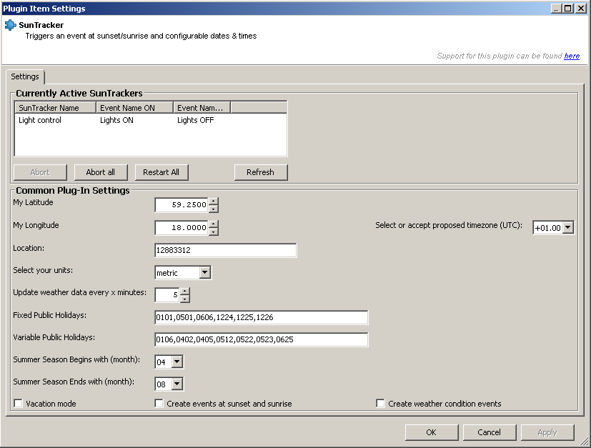

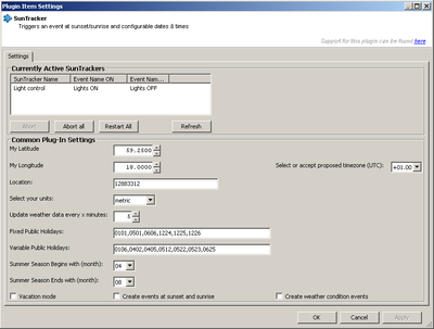

First step is to add and configure the plugin. Check the picture below, just modify with your longitude and lattitude etc. The yahoo weather location is not needed to change since we are not using weather conditions in this first setup.

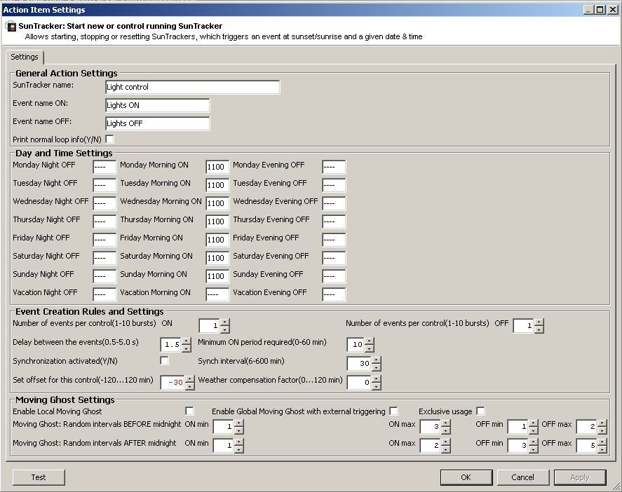

Next is to add and configure an action, put it under 'Autostart' so it gets started automatically. Just insert settings as in the example. It will generate events 30 min before sunset and 30 min after sunrise. You can then use these events to trigger macros for turning on/off your lights.

Thank you! I will try this. What is the 11:00am for? Also do i want to have the checkbox selected for create events at sunrise and sunset? My end goal is to not have to touch the light in my room and it will turn on automatically.

Just do as in the settings in the pictures. The setting for 11.00 is needed just to get the logic thing going (could be other time setting, but at least one is needed),
You will get an event as I said below. For the moment you do not need any other checkboxes ticked.

You should get an event half an hour before sunset and half an hour after sunrise. You likely also get an event when you restart the plugin (for synchronization purpose). The time for 11.00 is just to make the logic work, I need one time setting for this. (At 11.00 the sun should be up and the lights would not be turned ON).

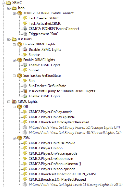

Another way to use it is when the motion sensor is tripped, it triggers an event which uses Suntracker to GetSunState. If it's successful, (i.e. the sun is up), jump to an event which disables your lighting folder, or else enable that folder.
I use a trigger of XBMC starting to do the same thing, but the same method would work with a motion sensor trip instead. I haven't incorporated the weather thing though.
